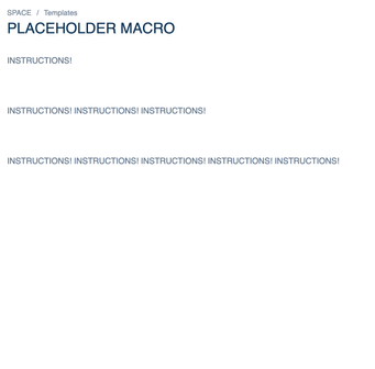

To test this, I created a new template in my Confluence site. Here is what it looks like:

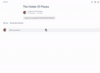

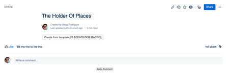

After that, I created a new page and placed the “Create From Template” macro in it. Here is what it looks like:
After that, I tried using the “Create From Template” macro. Here is what I see:

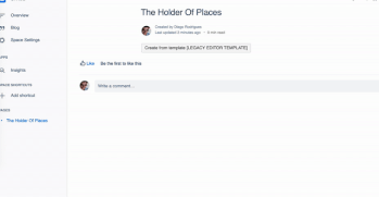

I also tried to do the same using “Instructional Text” with our Legacy Editor template. Even there, the placeholder text was present. Here it is:
