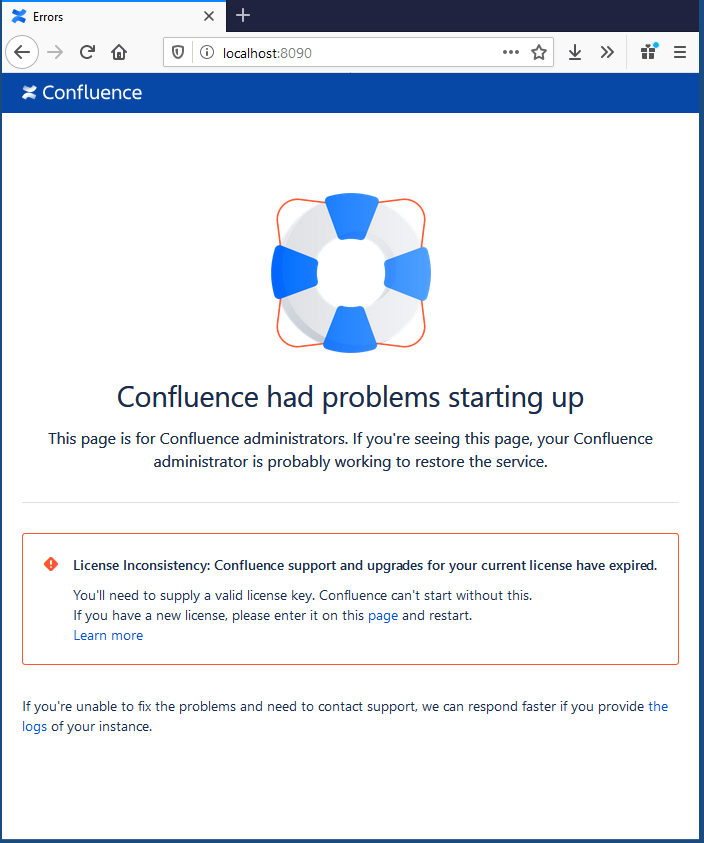

"License Inconsistency: Confluence support and upgrades for your current license have expired."
Robert Lauriston
July 8, 2020
I installed atlassian-confluence-7.4.1-x64.exe as administrator on Windows 10 Pro.
The error says to enter a license key, but there's nowhere to enter it.

@Robert Lauriston
A license key is requested at the very beginning of the installation procedure.
Wasn't that with your installation?
Why didn't you install the latest version of confluence?
Robert Lauriston
July 8, 2020
After the installer completed successfully, the browser window it opened was blank. After a few minutes I gave up and started looking at the logs. Ten minutes later I went to localhost:8090 and saw the above. I never got the usual interactive setup.
7.4.1 is the current long-term support release. I suppose I could try again with 7.6.0.
Robert Lauriston
July 8, 2020
7.6.0 worked. Likely the problem was that I neglected to delete the directories from a previous installation since I didn't think I'd installed it on this PC before.
