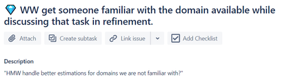

Task in Jira, containing an emoji in the title:

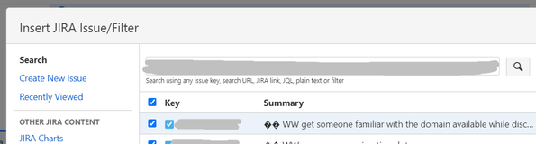

Macro settings dialog:
