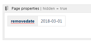

You can use page the page properties macro for that. Just put the macro on a page and put a table like that into the macro:
Then, add a label to the page, e.g. "toberemoved".

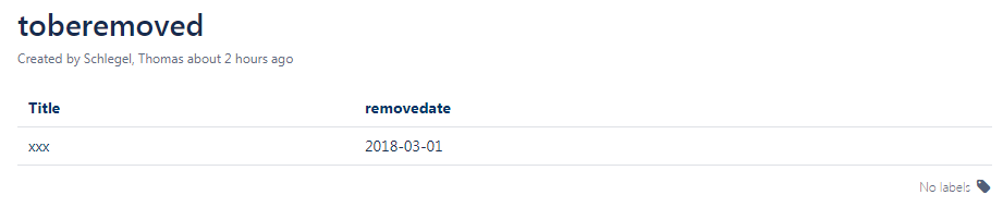

Is there any way to show the property "removedate" beside the page name and even sort the page on "removedate" ?
Yes, of course, the removedate is shown by the page properties report macro and you can also sort the columns:
