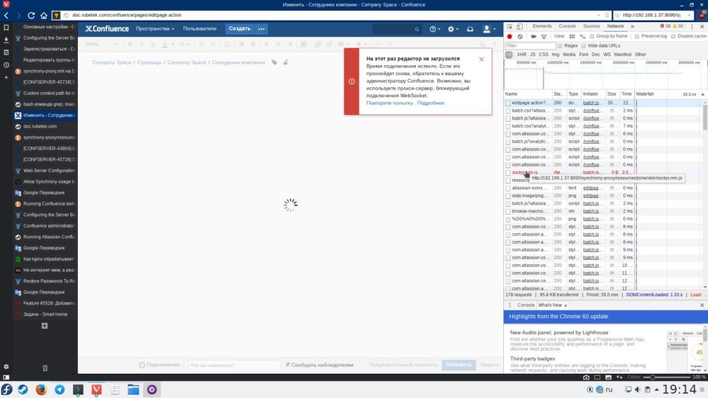

But, when we launch confluence editor,
One script file, will have url: http://192.168.1.37:8090/synchrony-proxy/resources/js/vendor/sockjs.min.js
(on screenshot)
Because of this doesn't work confluence editor.
Whats is this our error? Or maybe bag?
AnnWorley
August 18, 2017
Please make sure the Base URL is set to http://doc.rubetek.com.
The server.xml you posted looks fine as far as proxyName and proxyPort.
Please check your configuration against these 2 documents:
Troubleshooting Collaborative Editing
How to use NGINX to proxy requests for Confluence
I look forward to hearing what you find.
dmivsokolov
August 21, 2017
How to change base url if we don't have system-administrator user? Where is this settings option stored, Is it somewhere in
the configuration files or in the database? We have h2db.h2.db database
