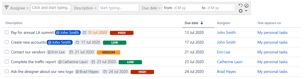

Standard Task Report:

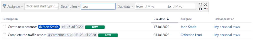

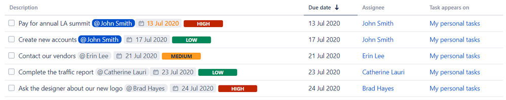

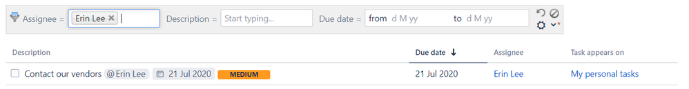

Paul 1.pngTask Report&Table Filter:Paul 2.pngFiltering by assignee:Paul 3.pngFiltering by description (priority):Paul 4.pngNote that our filter works with statuses and recognizes their text successfully.

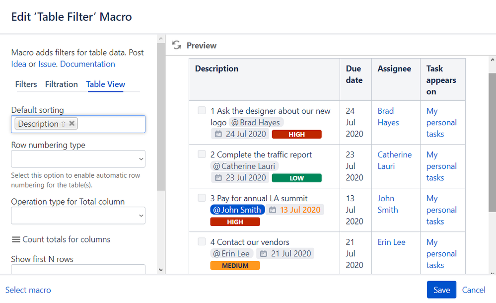

I was not aware that you can use this combination, we work like this now and we getting nearer, what is still missing is an sort function on description or on a filtered list, or am i missing something and is this possible?
Use case: workpackages that are planned in an order how they should be executed.The assignee and due dates are not sufficient, therefore our idea was to use a number in the description and sort on the numbering on alphabetic order (numeric order). but i cant find how.
Katerina Kovriga _Stiltsoft_
July 13, 2020
Hi @Paul Wijnen ,
The Description field is an unsortable one in Confluence, so it will be a little tricky to sort it.

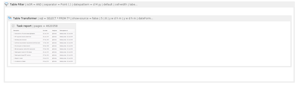

At first, wrap the Task Report macro in the Table Transformer macro (no changes in the settings required). Now all the fields are sortable.
Then wrap both macros in the Table Filter macro where your filters are set.

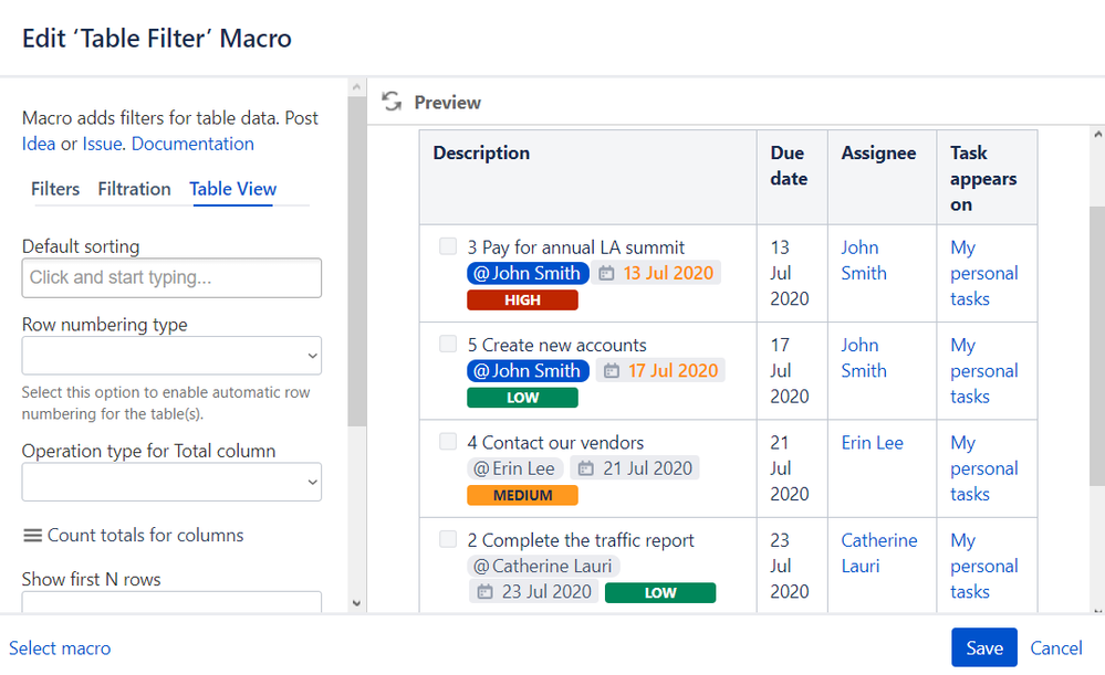

Paul 5.pngThe second step is to add the default sorting to your Table Filter macro.
Paul 6.pngPaul 7.pngAs you can see, now our sorting works just fine.

Hi! How did you add in the priority options? HIGH, MEDIUM and LOW?
Stiltsoft support
Atlassian Partner
February 9, 2023
Hi, use the standard Confluence Status macro.
