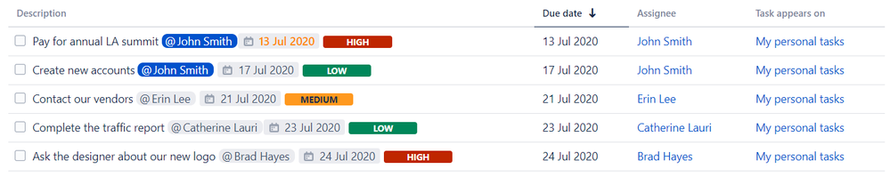

Standard Task Report:

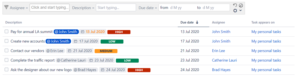

Paul 1.pngTask Report&Table Filter:

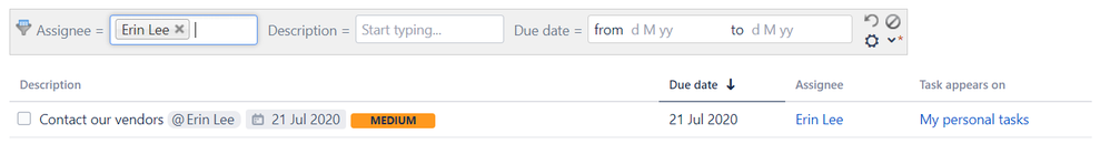

Paul 2.pngFiltering by assignee:

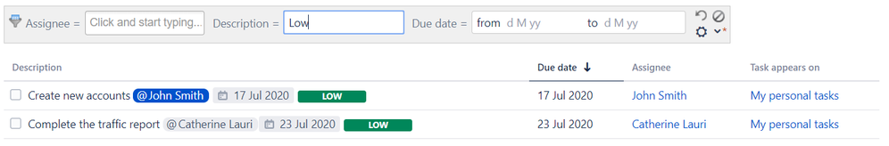

Paul 3.pngFiltering by description (priority):
