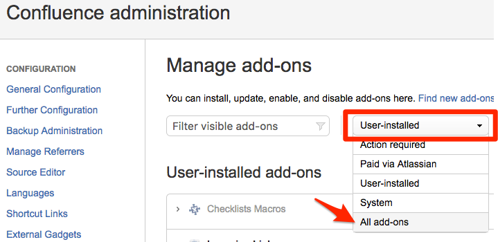

Now, for the actual plugin itself. I believe it's enabled by default so if it's not working, likely someone manually disabled it. Here's how to check:
  1. Go to the Manage add-ons page in administration
  2. Click on the dropdown that says User-installed and switch it to All add-ons (or system, this is a system plugin we're looking for)
  3. Search in your browser with Ctrl+F or use the Filter next to the dropdown to search for Mentions

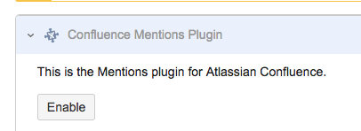

  4. If the plugin is disabled, it will be greyed out and you'll have an Enable button available when you expand it out. Go ahead and hit Enable if this is the case.
As a system plugin, you can't uninstall it. So it'll be there, either enabled or disabled. Let us know how it goes!

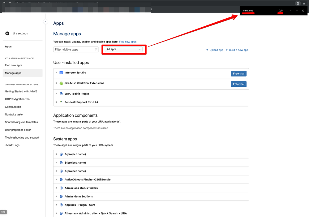

Francesco Mantovani
June 18, 2019
Unfortunately this is not the case for me.
As you can see I'm in the "All Apps" drop down menu but when I search in the page for the word [mentios] there are no "mentions":
Where am I wrong?
Francesco Mantovani
June 18, 2019
sorry
