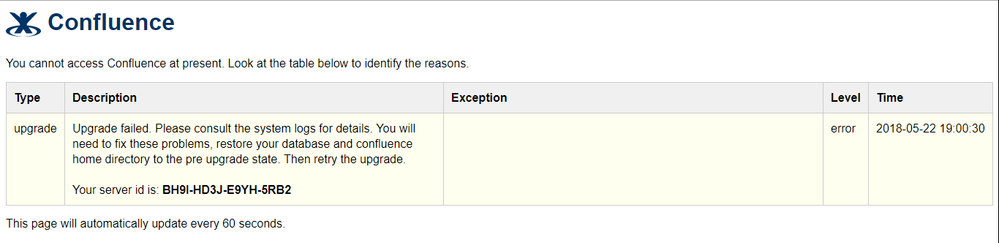

Found that its authenticating against AD, test server is working fine currently except backup issue. Now need to go 3.5.x,
When moving to 3.5 getting the attached error
Thanks!
