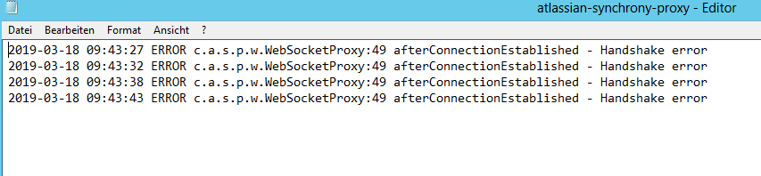

Taking a look at the logs I found this one:
2019-03-18 09:43:27 ERROR c.a.s.p.w.WebSocketProxy:49 afterConnectionEstablished - Handshake error

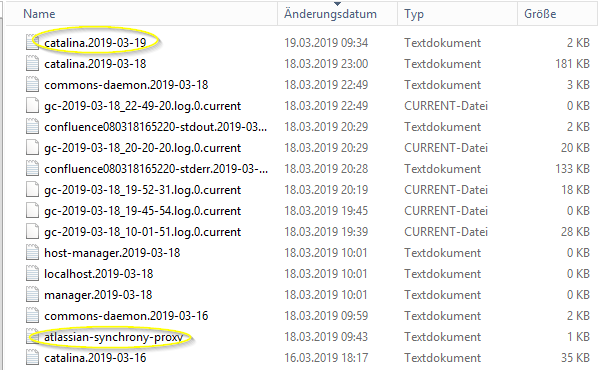

I found a catalina log:

I attach a screenshot of the whole conf log of the last days - the ones I send you are marked. The first one is attached, too. I hope I understand you the right way - there are no 'caused by' lines.

I'm happy we're at least able to rule out the firewall. Let's move onto reviewing the log files further.
Having a look at your list of log files, I'm not seeing the Confluence server log, which might be your issue.  I think you might be looking in the wrong location.
The Confluence log file is called atlassian-confluence.log.
Confluence uses the atlassian-confluence.log as its primary log, not the application server log.
  • Once the initial startup sequence is complete, all logging will be to<confluence-home>/logs/atlassian-confluence.log. For example:c:/confluence/data/logs/atlassian-confluence.log.
Note that the default location is the Confluencehome directory, not the application server's log file. The home directory is specified in<confluence-installation>/confluence/WEB-INF/classes/confluence-init.properties.
- via Working with Confluence Logs
Can you just confirm the screenshot you got is from <confluence-home>/logs/ and not another directory? If your Confluence started up successfully, then you should definitely be able to see the atlassian-confluence.log file.

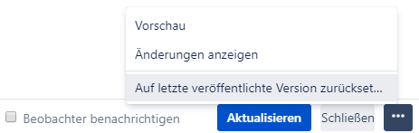

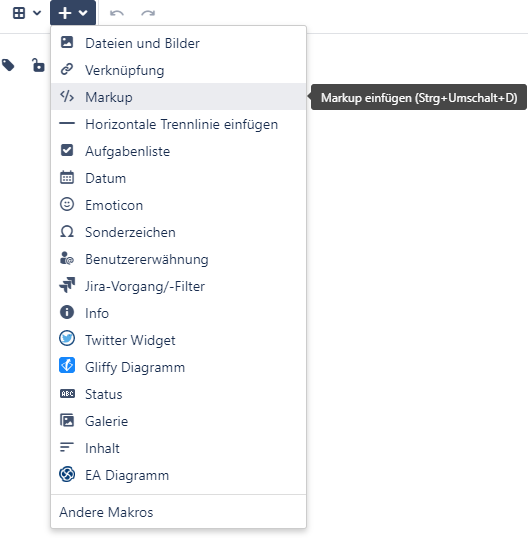

we sometimes have similar problems. I believe it happens after pasting text from other sources most of the time (Word, Excel, ...). What *may* help is discarding the changes and reverting to the last published version of a page. You can then redo the changes you made.
If you have to paste from Word, try using the "Paste Markup" option in the editor's macro menu. You will have to do any formatting in Confluence if you do that.
What definitely and always helps for us is just copying everything from that page and creating a new page with the copied contents. It's not a good option if you have hard coded links to the page ID somewhere, as this method will break them.
