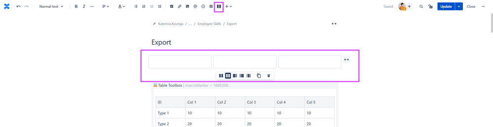

Hope that I’ve got your question right: to create several different charts based on the same filtered table, you need to use the Table Excerpt/Table Excerpt Include macros.
So, you’ll have the following structure of nested macros: Confiform Table View <- Table Filter <- Table Excerpt. We reuse your source filtered table with the help of the Table Excerpt macro.
If the tags are correct and you are on Confluence Cloud, you should use the Table Toolbox macro to wrap several macros one into another. For Server/Data Center you nest macros directly on the page.
Then to create three different charts on the same level, use the three-column page layout:
If you are on Server/Data Center, you may also use the Section/Column macros as well.
Now create the following structure for each chart: Table Excerpt Include <- Chart from Table. The source filtered table will serve as a source data for all your charts, but their types and other settings can be different and independent.

Hi @Brijendra Singh ,
The Table Filter and Charts for Confluence app supports the Confiforms for Server/Data Center. You may check this example from our documentation.
We saw the "table filter" macro on your screenshot and assumed that it was our Table Filter macro that is provided with the mentioned app.
If you are on Cloud and use the new editor, then there may be issues with macro nesting - you can't wrap macros one into another directly.
For example, for our macros we created the Table Toolbox macro - it's a special shell to nest our macros in Cloud and all macro sequences (Table Filter <- Table Excerpt, etc.) are built inside this macro and not directly on the page.
