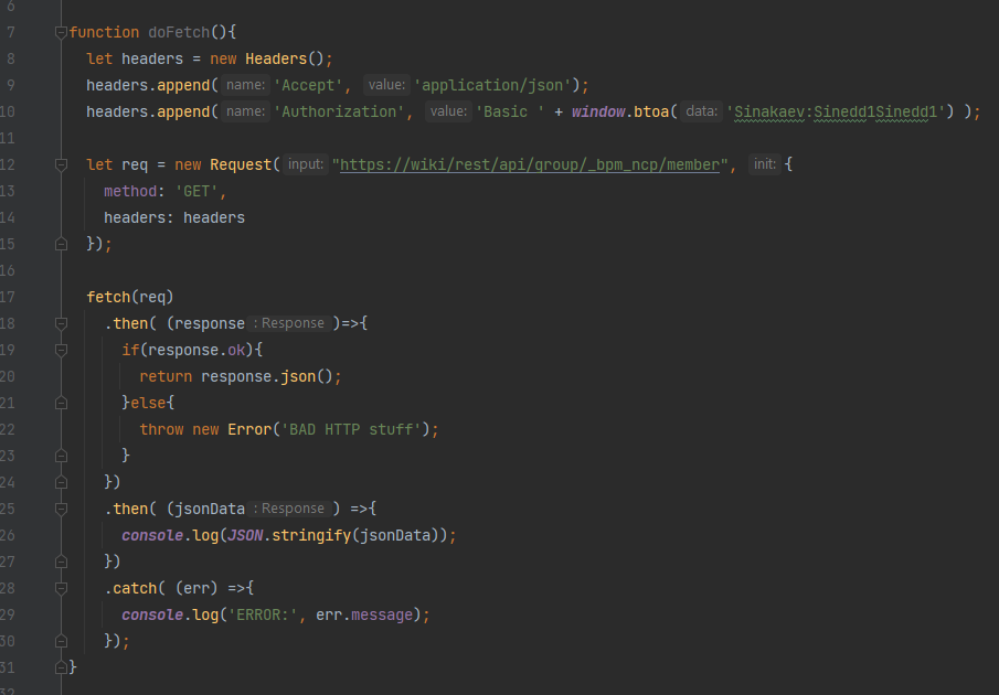

How to organize an interdomain network request in order to get an avatar?
My code:
Error:
I have an application which has:
1) Back => Spring Boot
2) Front => ReactJs
The back requests data from the Jira some data and displays it. Works through JiraRestClient, then it passes to front via Rest Api. Working fine.
Is it possible to somehow make requests to https://wiki/rest/api/user?username=Sinakaev from the front without CORS error?
I can not find more detailed documentation on Confluence.
Confluence is an Atlassian project, we have it deployed on-premise, maybe some configs can be changed through engineers.
