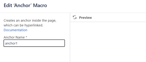

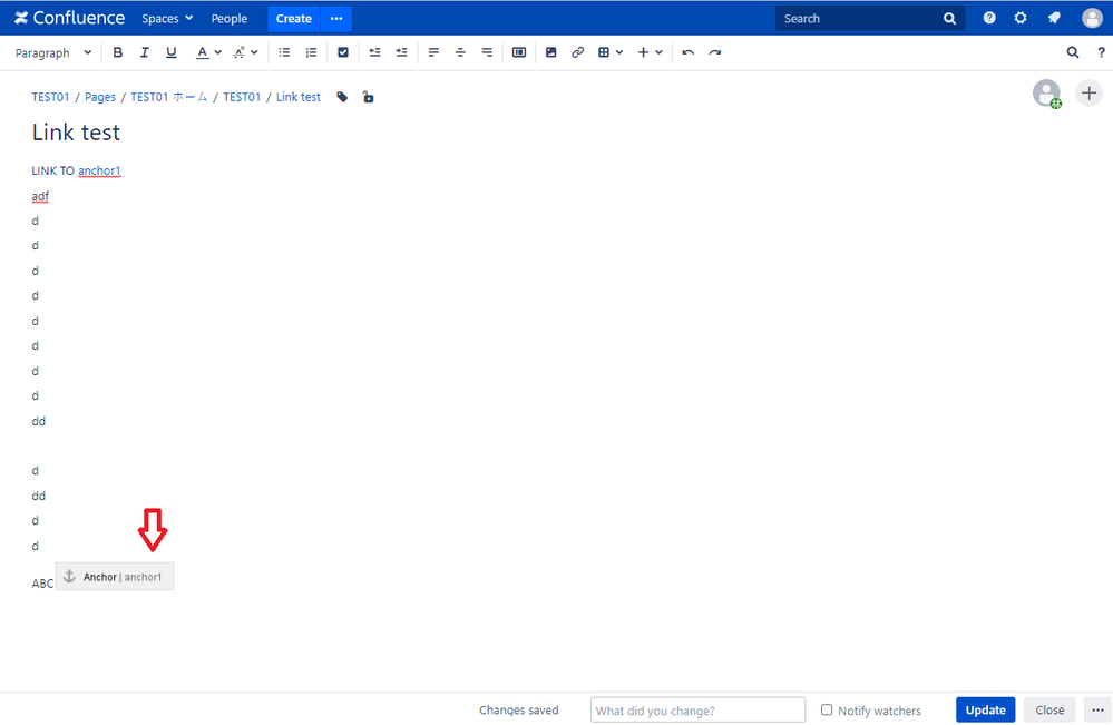

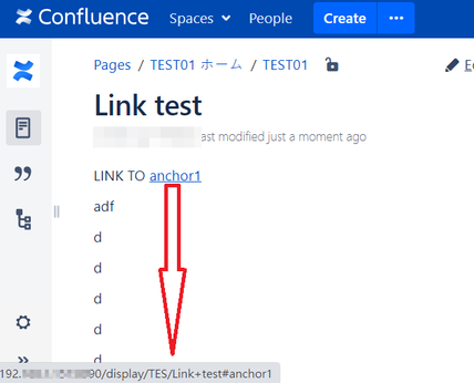

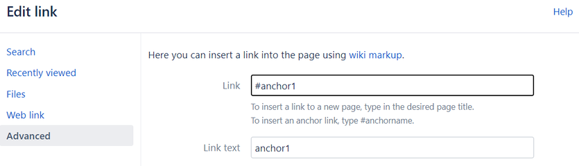

The Link has problem when it comes to link to the anchor on the same page.
1. Newly added Link cannot link to the anchor on the same page, but can link to the anchor on other page.
2. I click on a Link which used to link to the right position where the anchor was placed on the same page, but now it goes nowhere.
Server OS:Server 2019
Confluence :7.8.1

Hello @fineart fineart .
Adding Anchor with anchor1 id and linking to it as you showed above works.
Could you please show how the Anchor macros and where is added on the same page?

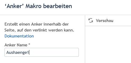

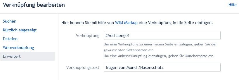

Marco Hölzemer
November 3, 2020
Thanks for the feedback! Maybe this feature has been around for a while, but when I set the link to the anchor, no spacekey/pagetitle info is added to the link. This info will be added to the anchor. That's why it can't work - the link won't find the anchor.
Link:
Anchor:

fineart fineart
November 3, 2020
Hi Andrii,
Thanks for the reply.
1.how the Anchor macros and where is added:
Click the + on the toolbar > select Other Macros > Click Anchor Marcro > Enter anchor name
2.What formatting does the text have next to the Anchor macro?
Paragraph
