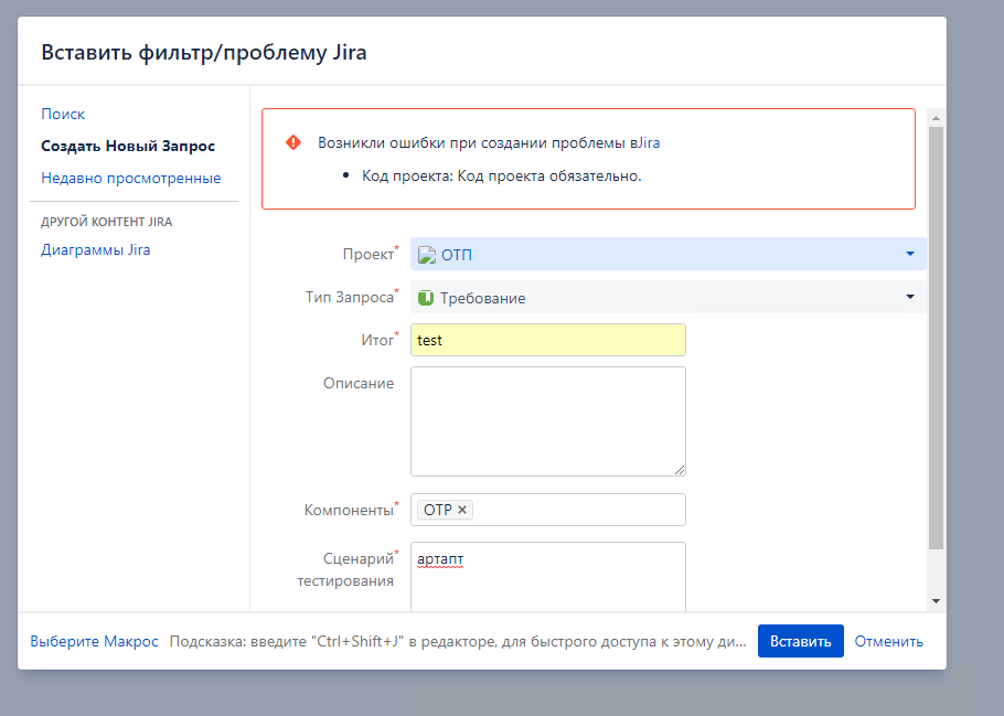

I installed the Jira and Confluent and customized links between them. i can see the projects from jira.
There is a problem when adding a request for a Jira from confluence. a message is displayed that there is no required field "project code".
But i can see the issues from jira on the confluence page.

December 5, 2018
i can create issues in Jira and i can see this issues in confluence/

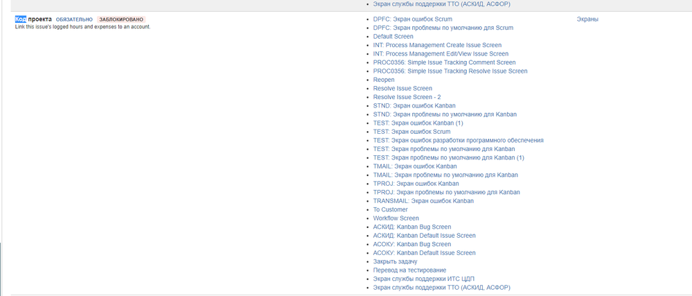

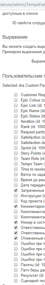

additional information:
i have Tempo Plugin installed on Jira server and i see this field in tempo configuration.
this field is present in field configuration

What happens when you try to create the same issue in Jira itself? Is there this field - “Код проекта"?
Now it seems to me like a globally configured required field issue. But I may be wrong, of course. Additional information is needed.
