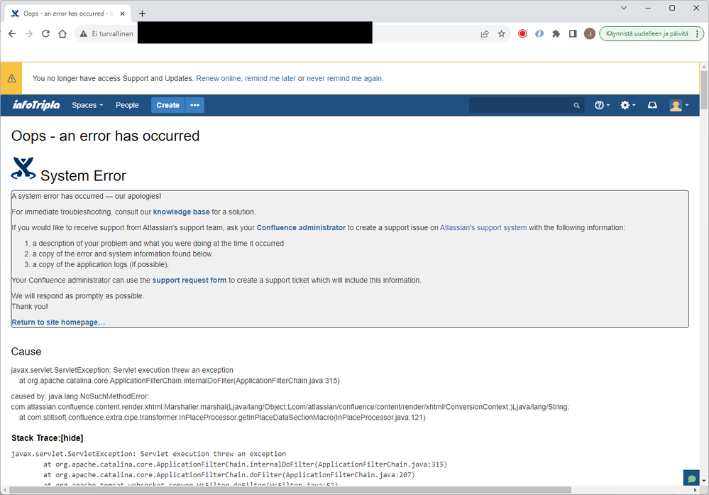

Confluence server version in Linux has been updated to 5.1 to 5.10.9
(5.10.9 so that migration to cloud could be done, but not higher because license doesn't allow it)
Page links have stopped working.
atlassian-confluence.log
2023-11-28 18:31:55,797 ERROR [http-nio-8980-exec-1] [[Standalone].[localhost].[/].[action]] log Servlet.service() for servlet [action] in context with path [] threw exception [Servlet execution threw an exception] with root cause
java.lang.NoSuchMethodError: com.atlassian.confluence.content.render.xhtml.Marshaller.marshal(Ljava/lang/Object;Lcom/atlassian/confluence/content/render/xhtml/ConversionContext;)Ljava/lang/String;

confluence-5.10.9.jar contains class Marshaller and it's method marshal which are shown in error message:
javax.servlet.ServletException: Servlet execution threw an exception
    at org.apache.catalina.core.ApplicationFilterChain.internalDoFilter(ApplicationFilterChain.java:315)
caused by: java.lang.NoSuchMethodError: com.atlassian.confluence.content.render.xhtml.Marshaller.marshal(Ljava/lang/Object;Lcom/atlassian/confluence/content/render/xhtml/ConversionContext;)Ljava/lang/String;
    at com.stiltsoft.confluence.extra.cipe.transformer.InPlaceProcessor.getInPlaceDataSectionMacro(InPlaceProcessor.java:121)
