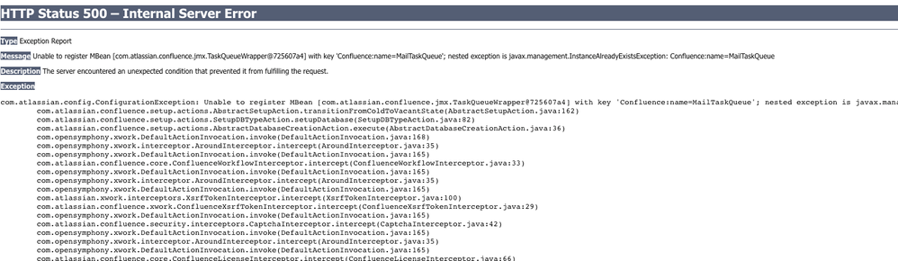

hi,
System environment:
linux :  CentOS Linux 7.5  , 2 cpu core,  4G memory
mysql: Ver 14.14 Distrib 5.7.24, for Linux (x86_64) using  EditLine wrapper
confluence: 6.12.1
error information:

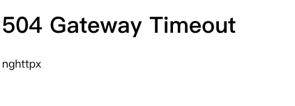

1. in the step of setup my own database,  a few minutes later, an error occurred.
2. refresh  the page, another error occurred.
Type Exception Report
Message Unable to register MBean [com.atlassian.confluence.jmx.TaskQueueWrapper@725607a4] with key 'Confluence:name=MailTaskQueue'; nested exception is javax.management.InstanceAlreadyExistsException: Confluence:name=MailTaskQueue
Description The server encountered an unexpected condition that prevented it from fulfilling the request.
Exception
org.springframework.jmx.export.UnableToRegisterMBeanException: Unable to register MBean [com.atlassian.confluence.jmx.TaskQueueWrapper@725607a4] with key 'Confluence:name=MailTaskQueue'; nested exception is javax.management.InstanceAlreadyExistsException: Confluence:name=MailTaskQueue
	org.springframework.jmx.export.MBeanExporter.registerBeanNameOrInstance(MBeanExporter.java:625)
I have tried many times, anybody have the same phenomenon? and how to fix it?  thank you very much!

hi @Nic Brough -Adaptavist-   I have try the resolution  of  "place jmxContext.xml in your <confluence-install>/confluence/WEB-INF/classes folder"   at first, remove all data  and drop the database ,  then  reinstall the confluence,  download the jmxContext,xml and do it as the follows, but it don't work.

I'm afraid "it don't work" is useless as a problem description.  For all we know from that, there could be a large penguin chewing your network cables.  What is the actual error?

Hi @lali bird
The following is the similar question answered please follow this article and let us know.
Thanks

thank you @Yoga Reddy {Appfire}  ,  the article you noted above can solve the second issue , but i have no idea what cause the  "504 Gateway Timeout" error in the first step.  may be another host port i need open more , except 8090, 8080, 80
