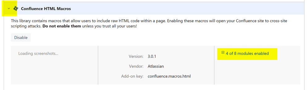

When you open up the list of installed plugins, find the Confluence HTML Macros plugin and click on the little > symbol on the left hand side to expand the pane. You'll see "x of y modules enabled" on the right hand side. Highlighted in this screenshot:

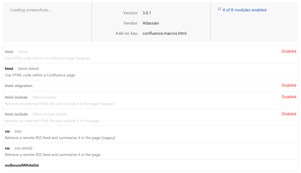

If you click on the + sign, that will list out all of the modules:
You can then hover the mouse pointer over any of the disabled ones and an Enable button appears.
