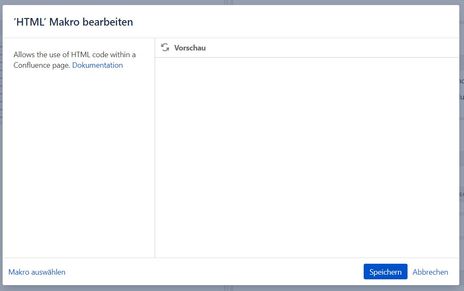

However, editing the macro, the parameter section is gone:
Also, the php code is not executed anymore.
Any idea what's wrong?

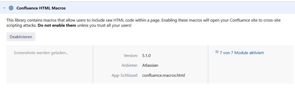

Hi @Frank Bonnemeier ,
are you sure that the HTML macro is enabled ? It was disabled by default on newer Confluence versions as it's a security issue, but you can follow instructions here on how to manually enable it again : https://confluence.atlassian.com/doc/html-macro-38273085.html
Let me know if this helps,
--Alexis
Frank Bonnemeier
September 6, 2021
yes, it is enabled.
Have a look here:
is it strang that screenshots are not loaded (left box)?
Alexis Robert
September 6, 2021
This might be a bug linked to this new version : I would advise getting in touch with support to further investigate : https://getsupport.atlassian.com
