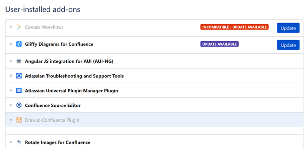

I installed draw.io plugin with a trial license for a self hosted confluence beginning of this year, to compare it to gliffy, which we were/are currently using. It went well and I decided to switch plugins when our license is extended (october). For the time being I left draw.io installed, but we didn't use it.
I probably should have deinstalled it, because now I have the problem that in plugin admin page it says draw.io is outdated, but the update button doesn't work and the detail page does not open either, so I can't even deinstall it. Even when i search for draw.io in the marketplace and click on 'buy now' nothing happens...

Hi, the update did work, but the result is still the same. The addon page won't show details for the plugin. Only the message that it's outdated ist gone ;) Comala still looks like Draw.io before the manual update. I have the same problem there.

Which section? If you are talking about Draw.io, it is opened up already, as you can see when you look at the little arrow on the lefthand side. What happens is, that it says Loading addon details and then it just shows a blank line.
