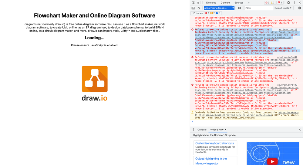

Recently, draw.io plugin seems to be broken on chrome.
I can't create new draw.io or edit from chrome.
It freeze on the loading page.
Error message says it is security problem.
By the way, I can create or edit it from safari.
Is there any solution?
Refused to execute inline script because it violates the following Content Security Policy directive: "script-src https://aui-cdn.atlassian.com https://cdnjs.cloudflare.com https://connect-cdn.atl-paas.net 'self' https://viewer.diagrams.net https://apis.google.com https://*.pusher.com 'sha256-avuoixynoo/05kdljyp0aobe+gt/ke1/vh2ps+yfqes=' 'sha256-r/ilw7kmsjxeo9eyqctzzyct0pz9ghn1blgki7vpr+a=' 'sha256-5dtsb5mj34lxcef+hfwbblef49xxjaknwgdwa/utwqa=' 'sha256-vs/mxlvd7nby7anv+0t1ap338uf7vrcs7y23kjerhkc='". Either the 'unsafe-inline' keyword, a hash ('sha256-AVuOIxynOo/05KDLjyp0AoBE+Gt/KE1/vh2pS+yfqes='), or a nonce ('nonce-...') is required to enable inline execution.

Hi @Junichi Sakaeda
Any browser extension installed in Chrome?

Junichi Sakaeda
November 9, 2022
Hi, @Marija Radovic
I use these extensions:
  • Checker Plus for Gmail
  • Google Offline Document
  • Google Translate
  • Intention
  • JSONVue
  • LastPass
  • Video Speed Controller
  • Auto Quality for youtube
Thank you.

I replied to the ticket Junichi submitted to our desk. I think one of the browser extensions are causing the issue but we will see if our suggestion to temporarily disable extensions will help Junichi. If not, we will investigate this further and debug.

I turned off all extensions on "chrome://extensions/" and try to edit drawio, but it still not work..
FYI, I try it with incognito window, it works.

I would change the browser now for pragmatic reasons. Is not the solution for Google, but could show you if it works in another browser and thus actually Google/Chrom responsible.

Agree with Gaby. Since it is working in Incognito mode, browser extensions/cache/ cookies might cause the issue so browser change is a good way to test this.
