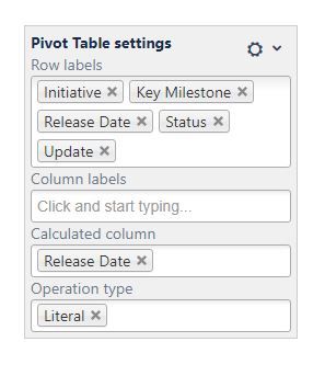

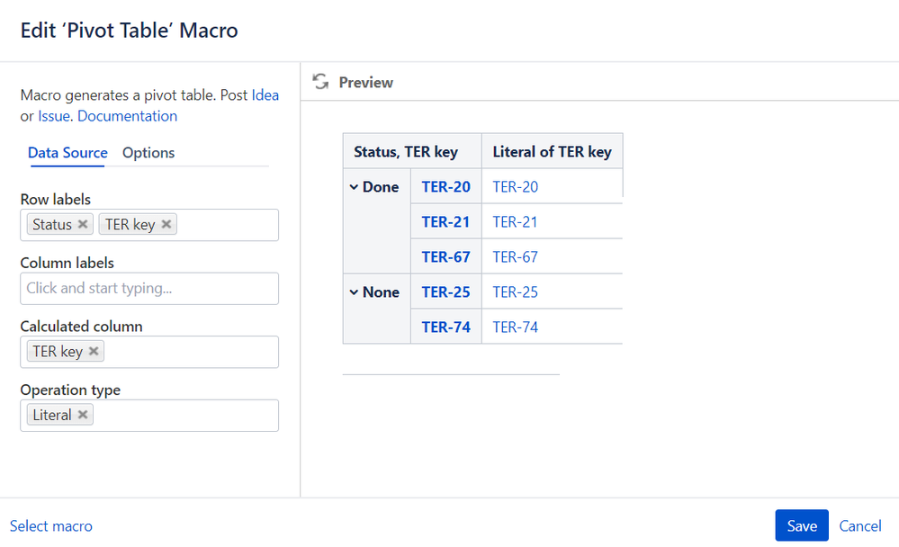

Hi,
I am trying to create a pivot table in that I don't want to display "Operation type" (Sum / Count/ Average / Literal) in my pivot table.
I want to remove Operation type in my pivot table view.
Is there a way to do it permanently? Any help is appreciated!
I tried editing the settings but its not working
Thanks!

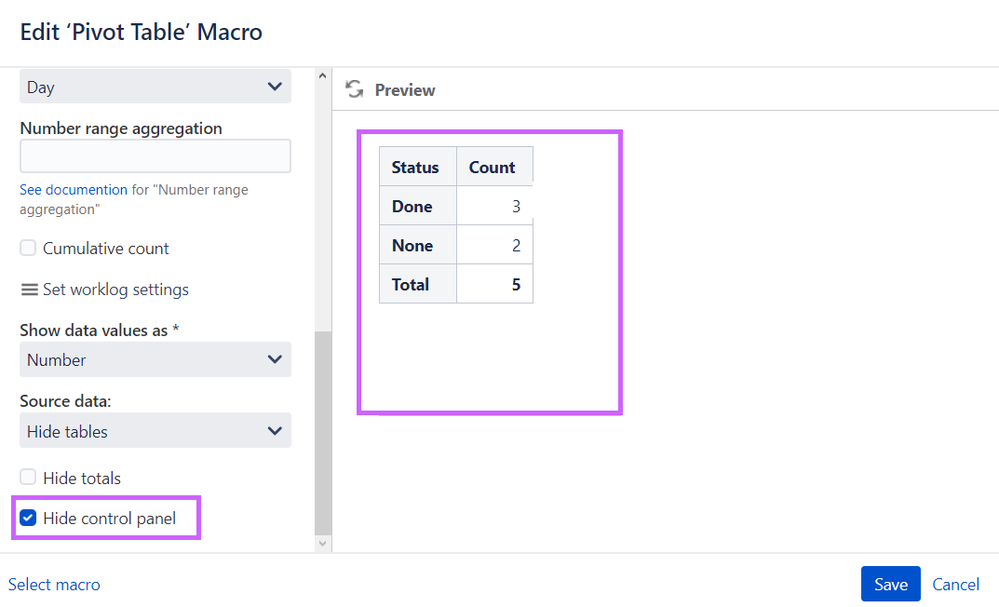

Hi @Sadeesh Narendran ,
We can suggest hiding the whole pivot panel into the view mode: go to the Pivot Table macro settings -> Options tab -> Hide control panel.

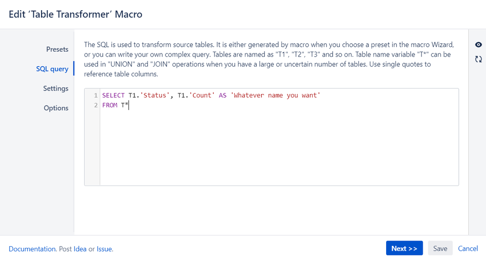

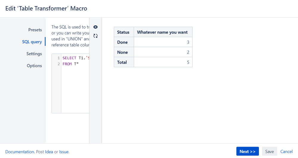

If you want to organize your result pivot table into a better way, you may rename its Operational type column - wrap your Pivot Table macro into the Table Transformer macro and use the following SQL query:
SELECT T1.'Status', T1.'Count' AS 'Whatever name you want'
FROM T*
If you don't want to show this column in the result table at all, just don't list it in you SQL query. For example, "SELECT T1.'Status' FROM T*" will publish only the first "Status" column.
Hope it may help your case.
Sadeesh Narendran
July 12, 2021

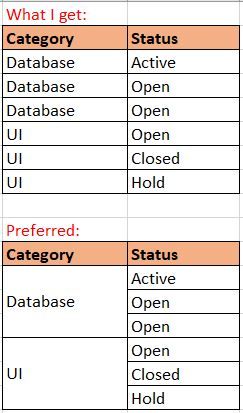

@Katerina Kovriga _Stiltsoft_ Thanks Katerina! Here again when I use SQL i get all listed duplicate items, but I want the rows to be merged something like below.

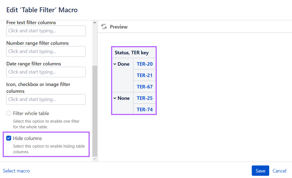

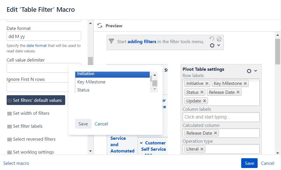

Now you go the the Table Filter macro settings -> Filters tab and check the Hide columns option:

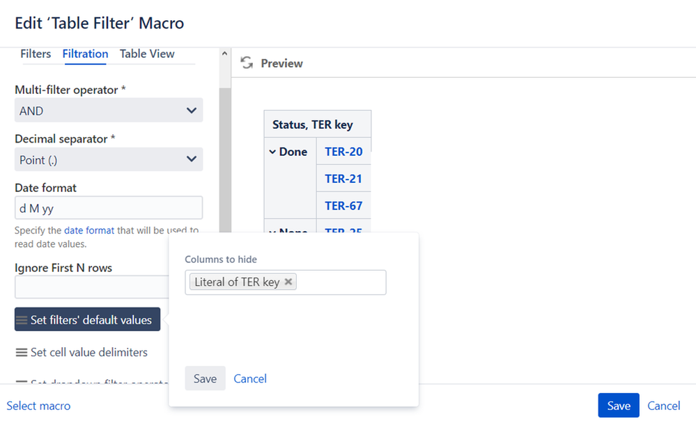

And navigate to the Filtration tab -> Set filters' default values and choose the last column which you want to hide:
So, the structure of your pivot table will be preserved.
Sadeesh Narendran
July 13, 2021
@Katerina Kovriga _Stiltsoft_  Thanks for your step by step explanation. I did followed all your steps but Im not getting that column "Literal of Release Date" to hide.
July 13, 2021
Hi @Sadeesh Narendran , it's a strange situation - if you see the column into the Pivot Table macro, it should be also visible via the Table Filter macro.

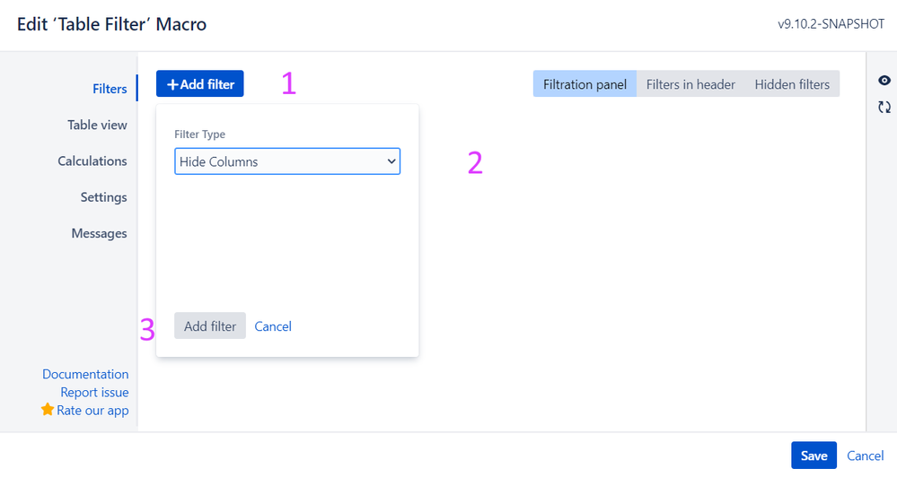

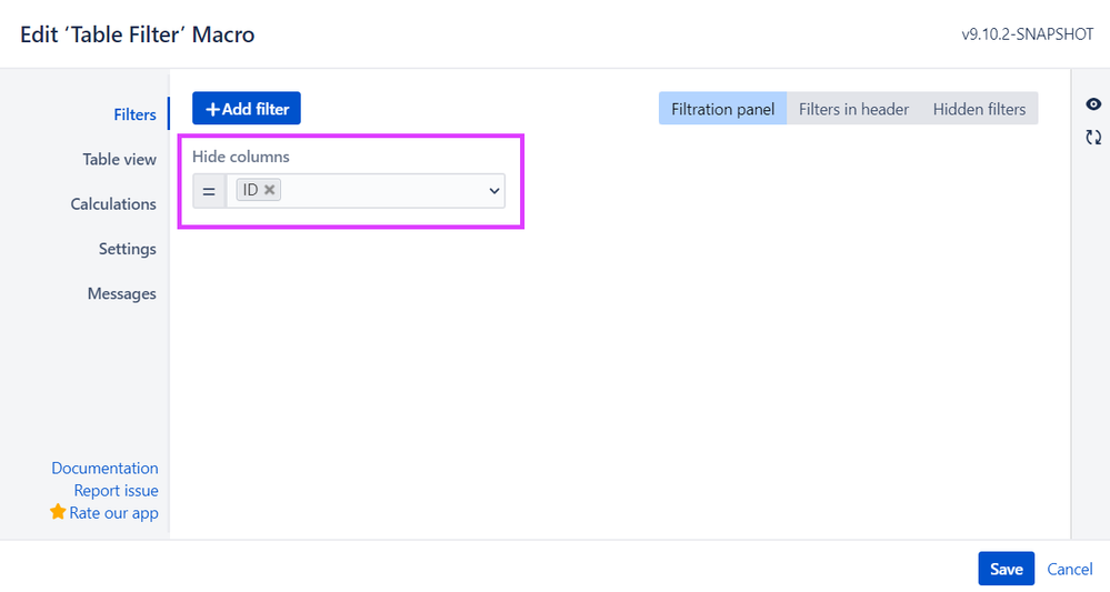

To hide unwanted columns, use the Table Filter macro on top. The “Hide column” option was moved to a different place in the new macro UI.
Please check the screenshot below:
Click on the Add filter button, choose the Hide columns filter type, and hit the Add button.
Now simply add the columns that you want to hide:
Hope it helps your case.

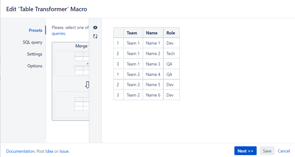

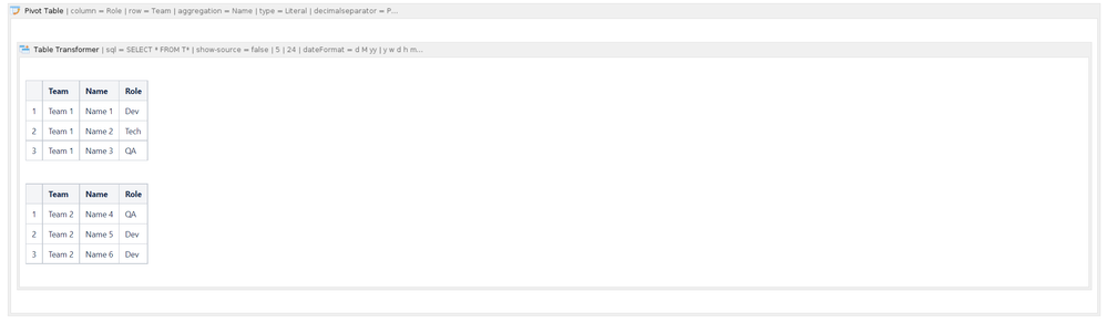

Thanks @Katerina Kovriga _Stiltsoft_ the amazing thread above. I am facing one issue after following the above all the instructions.
my setup -
  1. I am merging two tables
  2. creating pivot
  3. filtering that table
but I am not able to get expected.
  • 2 tables =>
2022-05-19 22_08_46-Mouse Highlight Overlay.png2022-05-19 22_08_56-Mouse Highlight Overlay.png

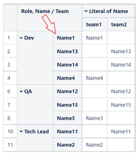

and after following the above all instructions I reached at this output
but want to hide the Name column (red arrowed) .
and when I tried to do the same via hiding that column .
it makes it shown as below. the team1 table header label is gets missed .
Is it some issue or I am missing something. ?

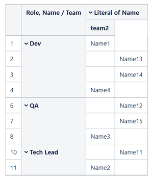

May 19, 2022
Seems that your Pivot looks not like mine, please attach a screenshot of the Pivot Table macro settings. It seems that you use the Name column twice and get a kinda strange aggregation: first in one column, than in two columns divided by teams.
And again in the initial example you should hide the Literal of Name column. So, maybe give a structure of the result table that you want to achieve.

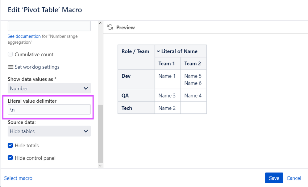

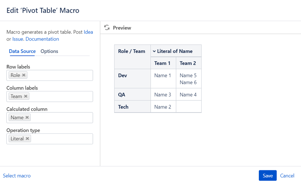

May 20, 2022
I can suggest such settings for your case:
Seems that the result table looks exactly as you need.
Deleted user
May 20, 2022
Oh My god! My expectation was different but this is superb and amazing and much better Katerina Kovriga _Stiltsoft_  .
I was trying to make each team member name in different rows actually and spent some hours, but I guess that is not possible 😇
But this is really amazing and simple to go ahead with ✔ .
Thank  you @Katerina Kovriga _Stiltsoft_ ⚡ 🤘 .
