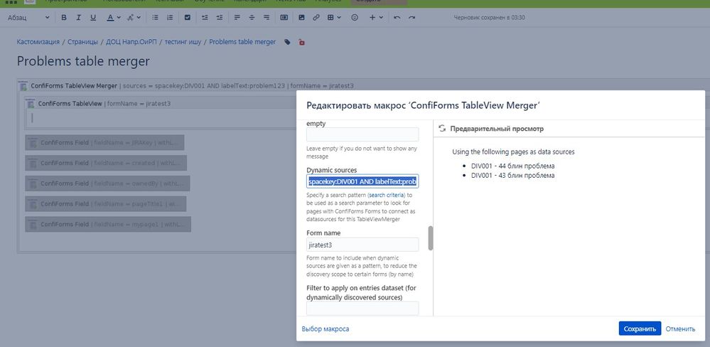

Kuanysh Belsariyev
June 10, 2024
@Alex Medved _ConfiForms_ could you please show me, how i can make report with tableview merger with labels? Code or some links to vertuna cookbook?
I tried but it doesnt display any table
June 10, 2024
Overall, the configuration is what it should be
Do you have forms with a "jitatest3" on those pages that you see in the TVM macro preview?
Alex
Like Kuanysh Belsariyev likes this

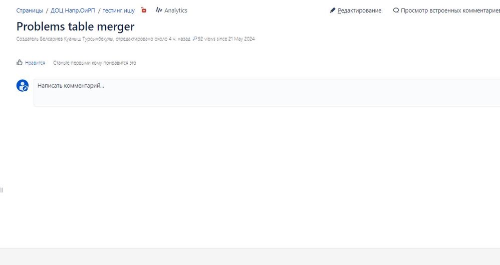

Kuanysh Belsariyev
June 10, 2024
Finally, your advice has prompted me to solve the problem. God bless you!
The form "jitatest3" was higher up the page
