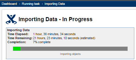

From the application I tried to restore the WIKI Prod backup to test environment but facing the issue i.e. restoring the backup is taking a long time. I have faced the same issue on earlier as well.
Please find the below snapshot:
Please suggest me is there any other possibilities to import the data from Production to Test.

The alternative to importing is to restore a database backup and a copy of the system's home directory on to the test server.

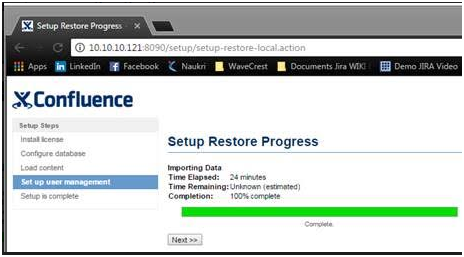

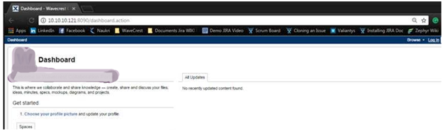

To importing is to restore a database backup and a copied of the system's home directory onto the test server.After copied the home directory, edited the file in the root of the home directory that contains the database connection information. Because we have copied Production data, so need to change prod settings in there, So we have changed them to point to the test database.After I restored the database into the test one, start up the test Confluence. à Getting DB issues so I have contacted DB Team and worked on database issue. He fixed the issue after that again I tried to restore but failed to restore.
3)  I have gone through the wiki knowledge base and search the articles I found the solution:
a) Increased Java Heap Size
b) Increased application timed out seconds.

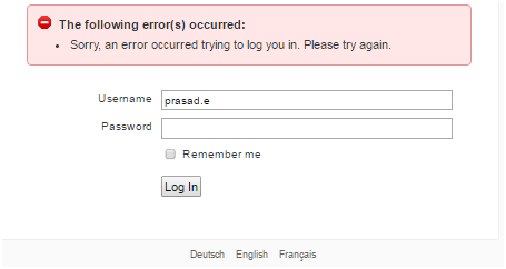

c)Restart the wiki applicationAgain I have started to restore the backup from prod to test using zip file including attachments. Restored successfully but unable to login with prod credentials due to some authentication issues.
Please suggest me on
Nic Brough -Adaptavist-
June 20, 2017
You'll need to read the logs to find out what is going wrong.
Prasad Andrews
June 20, 2017
2017-06-16 12:40:34,516 ERROR [http-8090-4] [crowd.manager.application.ApplicationServiceGeneric] authenticateUser Directory 'JIRA Server' is not functional during authentication of 'prasad.e'. Skipped. 2017-06-16 12:40:34,519 WARN [http-8090-4] [atlassian.confluence.user.ConfluenceAuthenticator] authenticate OperationFailedException caught while authenticating user <prasad.e>. com.atlassian.crowd.exception.runtime.OperationFailedException         at com.atlassian.crowd.embedded.core.CrowdServiceImpl.convertOperationFailedException(CrowdServiceImpl.java:869)         at com.atlassian.crowd.embedded.core.CrowdServiceImpl.authenticate(CrowdServiceImpl.java:79)         at com.atlassian.crowd.embedded.atlassianuser.EmbeddedCrowdAuthenticator.authenticate(EmbeddedCrowdAuthenticator.java:30)         at bucket.user.DefaultUserAccessor.authenticate(DefaultUserAccessor.java:589)         at sun.reflect.NativeMethodAccessorImpl.invoke0(Native Method)         at sun.reflect.NativeMethodAccessorImpl.invoke(Unknown Source)         at sun.reflect.DelegatingMethodAccessorImpl.invoke(Unknown Source)         at java.lang.reflect.Method.invoke(Unknown Source)         at org.springframework.aop.support.AopUtils.invokeJoinpointUsingReflection(AopUtils.java:307)         at org.springframework.aop.framework.ReflectiveMethodInvocation.invokeJoinpoint(ReflectiveMethodInvocation.java:182)         at org.springframework.aop.framework.ReflectiveMethodInvocation.proceed(ReflectiveMethodInvocation.java:149)         at com.atlassian.spring.interceptors.SpringProfilingInterceptor.invoke(SpringProfilingInterceptor.java:16)         at org.springframework.aop.framework.ReflectiveMethodInvocation.proceed(ReflectiveMethodInvocation.java:171)         at org.springframework.transaction.interceptor.TransactionInterceptor.invoke(TransactionInterceptor.java:106)         at org.springframework.aop.framework.ReflectiveMethodInvocation.proceed(ReflectiveMethodInvocation.java:171)
June 20, 2017
Your Confluence is trying to connect to a JIRA server to get a user directory, but it cannot reach it, or is not authorised to use it.
You'll need to enable it, or make some database tweaks to use a different directory - see https://confluence.atlassian.com/doc/restore-passwords-to-recover-admin-user-rights-158390.html
