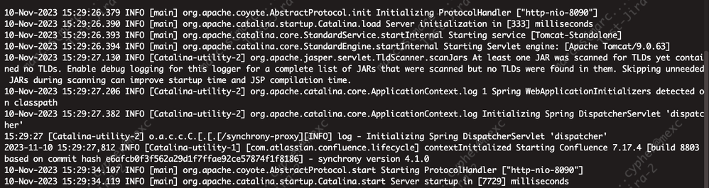

1、Confluence server started: catalina.out logs:

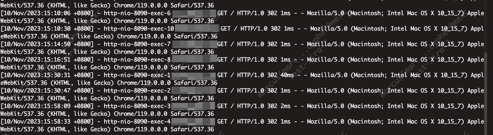

2、Request from browser is received by confluence server: conf_access_log.2023-11-10.log:

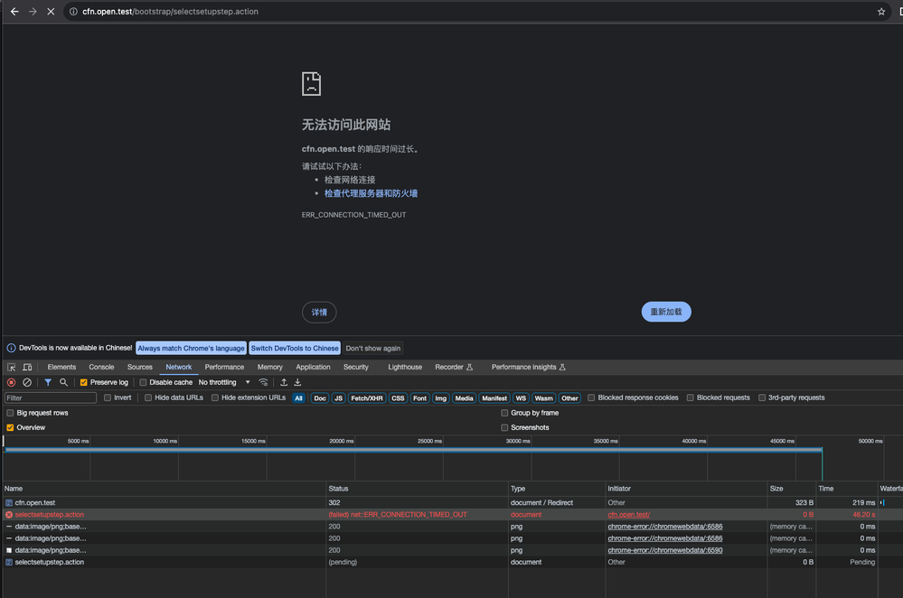

3、but we cannot access confluence: (not find any error logs)
So, could you help us with this issue?

We have NG before Confluence, and we checked the NG logs, it seems NG forwarding the browser request to our Confluence server is all right.
That's why we post our conf_access_log above, it shows NG's request was received and then Confluence server forwarding it to /bootstrap/selectsetupstep.action
But we haven't found any error logs on Catalina.out.

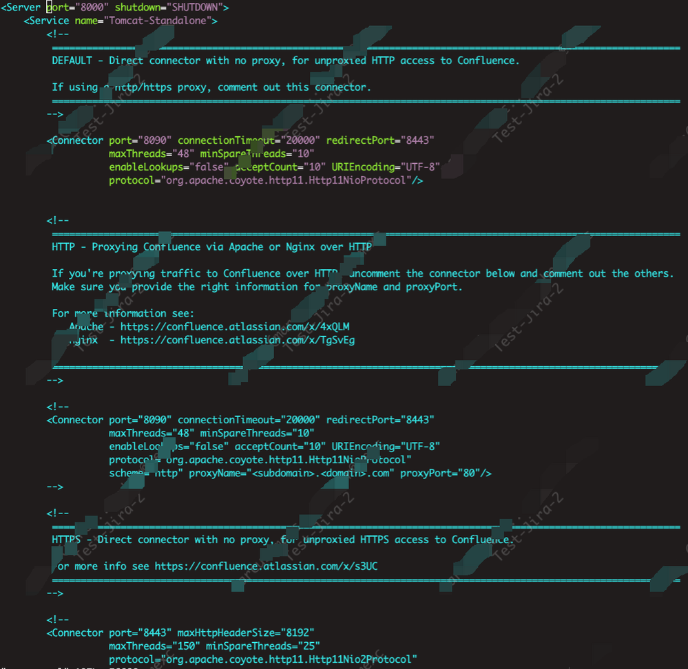

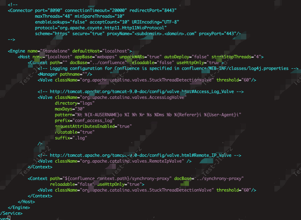

Below is our Confluence server.xml, whether it helps:
Thx/Br

Hi @Yong Xin Choon,
You will need to properly edit the server.xml file - comment out the current connector block and uncomment the part for NGINX. Please see to Running Confluence behind NGINX with SSL
I think you will now have Confluence accessible at http://localhost:8443.

Thanks Pavel,
I tried the way you mentioned above, it works, thanks!
