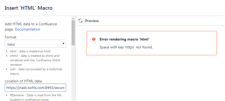

confluence macro by bob swift is not working properly.
we are trying to use the html macros by bob swift to embed the jira url . but we are gettin the error space with https key not found .
Please help
Deleted user
May 16, 2019
Hi @BrahmaReddy Seelam - Consultant,
Thank you very much for using our app HTML for Confluence.
In order to embed the Jira URL, you have to prepend # to the url as shown below.
  • #http://<your-server-url>
By doing the same, your data is going to read from the URL specified. Please test and let us know how it works.
Thanks,
Raja
