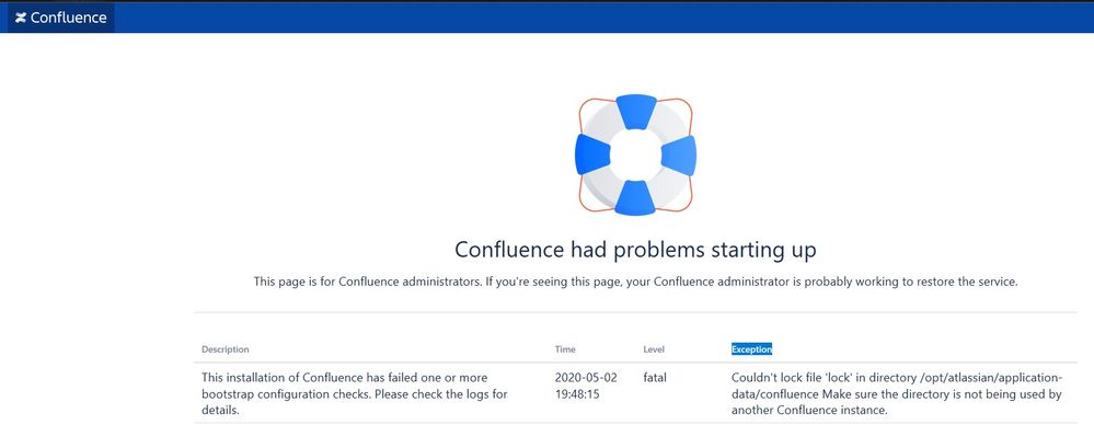

This a frustrating error, confluence keeps failing to start property after rebooting our server.
We are running confluence/ Jira/ Bitbucket on a redhat server.
After reading the log files and doing lots of research I found that I need to I have to stop the confluence, kill an application that listens to port 8000 which was java, then restart confluence, and it works, but until next time we restart the server.

The interesting part is that the error, which is shown on confluence web page, seems to be irrelevant,

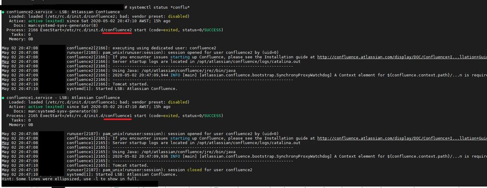

Hi @hadi.ariakia
This might occur if the Confluence instance was not stopped properly. And its a possibility that a previous instance of Confluence is also running.
Can you check that multiple Confluence instances are not running in your scenario?

Hello @Deepanshu Natani
You are exactly right. I have no idea how two confluence service files have ended up to exist in one server! The both files were identical. In fact, one confluence is installed, but two service files and two instances were being created at the startup. To solve the problem I just deleted one service file manually, reboot the server and now everything works as intended. Thanks again mate.
