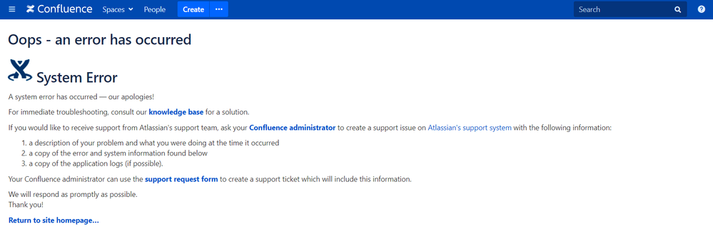

i have a problem here on my Confluence instance, its working correctly on all pages but when i want to go to the General settings or any other administration page which required to Re-Do the authentication and when i entered my password i got this Error page ( screenshot).

can you share log file from INSTALL-DIR/logs/catalina.out when it happened?

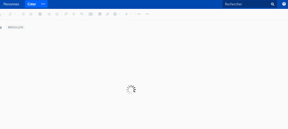

i see that i cannot even create a page !!! please whats the problem
