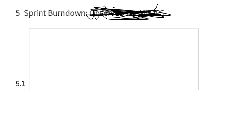

Yufei Zhu
June 29, 2022
i can also confirm the same problem! There was supposed to be a chart in my following attached picture but if i use " export pdf " plug-in, it end up not able to export the chart at all. And if i do right click and save as pdf, it exports the chart 90 degrees rotated. It's been a while since this problem has been last raised. any solution/updates so far?Screen Shot 2022-06-29 at 8.42.40 AM.png
