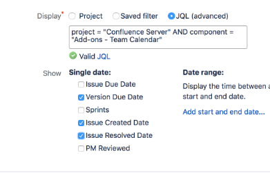

I encountered an issue while creating an event on the team calendar. Please see the attached screenshot below.
As far as I know, there should be a Display "Radio Button" where I can choose an option such as Project, Saved Filter, or JQL(Advanced).
Some of my colleague has that option, I'm wondering why is not there on my end.

Hi Ysaac! Thanks for sharing this information.
Looking further, I am able to replicate this behaviour consistently. The result I showed earlier was on a personal instance.
The difference between instances (both where Confluence 6.12.2 and Jira 8.0) was the authentication set in the Application Links.
When I changed it to OAuth (impersonation) I was able to have the desired results.
With this in mind, could you check if the application link is set at OAuth (impersonation)?

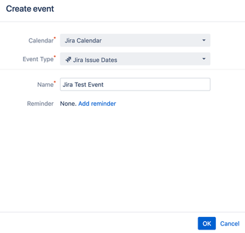

Hello there! Thanks for sharing with us Ysaac.
I tried creating a Jira Issue Date event and had the same dialog window shown:
