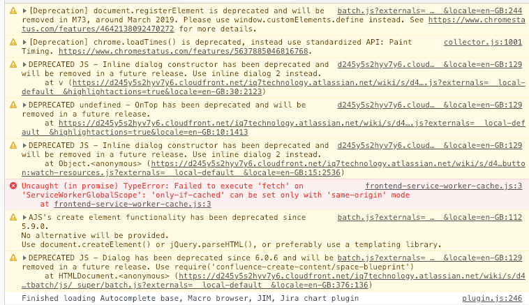

(a) the root page is defined within the Page Tree macro; and then the macro itself is in edit mode, the dynamic content is accurate
(b) the page has been published
(c) there were console messages as shown below
roman
January 2, 2019
@Chris Olofson,
try to clear the cache and local storage in Chrome: http://superuser.com/questions/519628/clear-html5-local-storage-on-a-specific-page.
Did this help?
Roman.
Chris Olofson
January 2, 2019
That worked, thank you very much for the  recommendation
