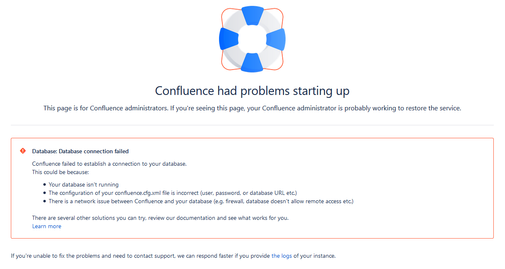

Hi,
I recently migrated my H2 Database to a MS SQL Database. Because of the Server configuration I had to use an Domain-User. I followed this issue and combined it with this Articel to get a connection.
After that the installation and dataimport finished without problems. Then I installed the Confluence-Service. When I tried to start Confluence through the service I got an error message:
The startup_bundled_jre.bat starts Confluence as intended. I suspect the login data is not used correctly from the service, until now I wasn't able to solve the problem.
Can someone help me please?
Thanks!

May 5, 2020
Have you checked the 3 points of the error message?
The DB user used by Confluence must have rights in the Confluence DB as Admin
How did the H2 to MS SQL migration take place?

May 5, 2020
Hi,
thank you for your answer.
I created an XML backup file and copied the attachment folder. Douring reinstallation of Confluence an Import backup option appeared that I used.
The Database is running. The DB user used by Confluence has rights as Admin and like I said when I use the startup_bundled_jre.bat Confluence is functioning as intended. Confluence receives a connection and all imported Data is available.
Only if I try to start Confluenc as a Service I get this problem. Is it correct that the Service uses the same connection information as the startup_bundled_jre.bat?

May 6, 2020
You seem to have set up the service incorrectly. The start parameters are either incorrect or incomplete.
Are you sure you followed these instructions?
https://confluence.atlassian.com/doc/start-confluence-automatically-on-windows-as-a-service-172071.html
https://confluence.atlassian.com/doc/setting-the-java_home-variable-in-windows-8895.html

May 6, 2020
Hi,
thank you for your replay.
I figured out a solution for my problem. My mistake was the login information for the Confluence service. If you look at the “Log On”-Tab of the service properties, you can change the executing account. By default, the Local System account is selected. I had to change the account to the domain user with database rights. Additional I extend the account rights to a degree that the user could log on as a service.
