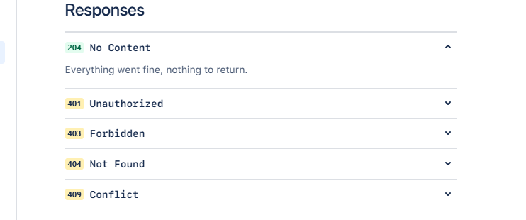

I made an API request to the "Deactivate a user" endpoint. I got the "204 No Content" response that supposedly means it worked. But when I went into the admin console, the user was still only suspended and not deactivated.

I would check where you are reading the status. The Users page and the Managed accounts page report two different things. Deactivating an account at the org level sets the managed account to Deactivated, while the site-level Users list keeps showing the person as Suspended because that is how it labels someone with no product access. So a 204 plus "suspended" in the user list is the expected end state.
I would confirm it here: admin.atlassian.com > Directory > Managed accounts > open the account and look at Account status. If it says Deactivated there, you are done, and the person cannot log in.
