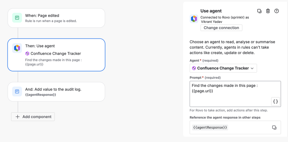

I have created an automation rule in Confluence. The purpose of this rule is to create a Jira issue whenever changes are made to a Confluence page.
In my automation:
However, the rule gets stuck at the "Rovo Agent" action. It keeps showing Waiting, and eventually, the rule aborts.

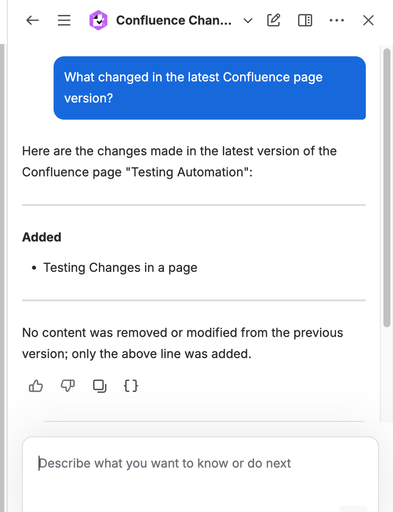

I’m not sure how to fix this. The agent works fine when accessed via the "Ask Rovo" option, but within the automation rule, it remains stuck in the waiting state.

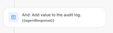

As you can see in the screenshots below, I have already added {{agentResponse}} in the log action.

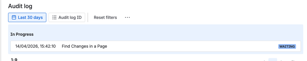

However, the agent is not triggering. The automation stops at the agent action and shows the status as "Waiting", and after some time, it gets "Aborted."
I am not sure why the agent is not triggering.

I can confirm the behaviour, the automation get stuck in "Waiting" and after some time goes to "Aborted"

Agent is working when asking the agent from "Ask Rovo" section.
But in Automation rule, it's keep on showing wating and after sometime rule "Aborted", rule stuck at "use Agent" action.
