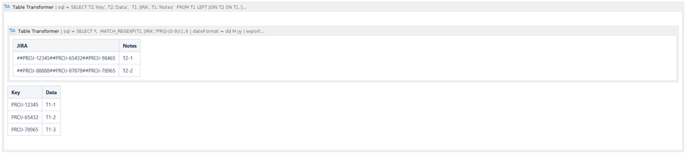

Also I've tried to recreate your case by the description and got smth like this:

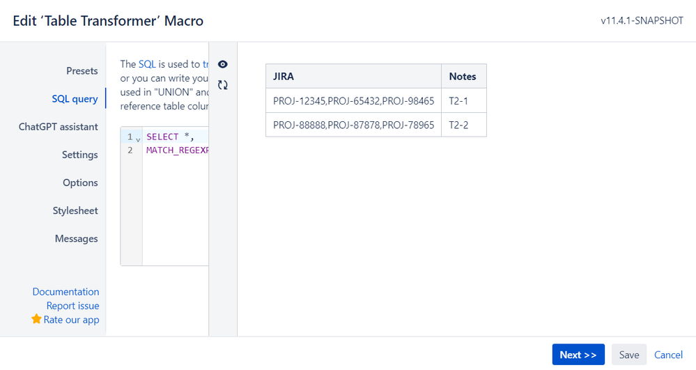

In the internal Table Transformer macro we get rid of the ##:
SELECT *,
MATCH_REGEXP(T1.'JIRA',"PROJ-[0-9]{1,6}","g") AS 'JIRA' FROM T*

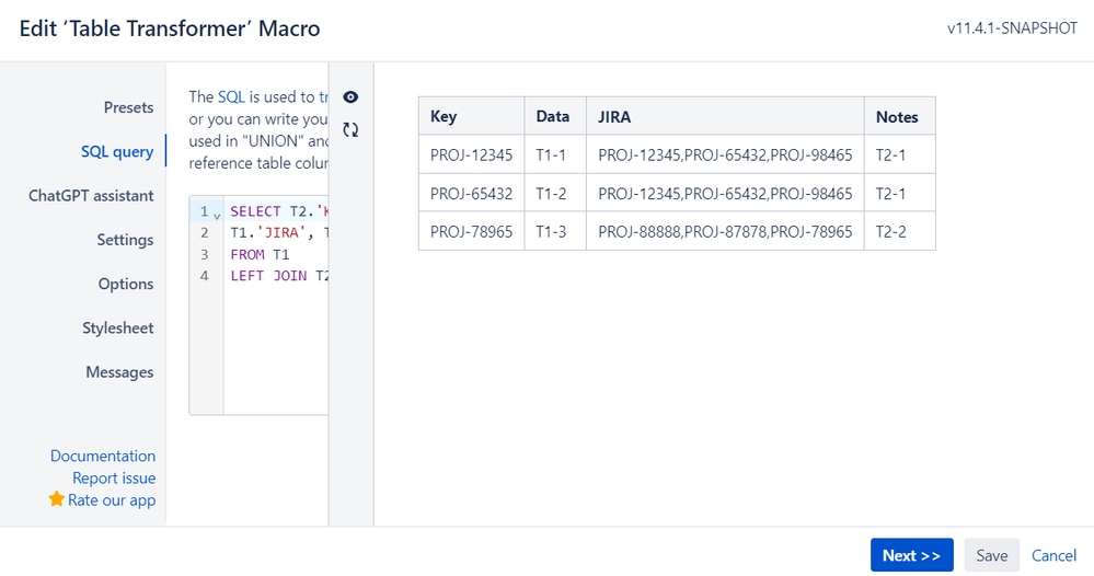

In the external Table Transformer macro we join our tables:
SELECT T2.'Key', T2.'Data',
T1.'JIRA', T1.'Notes'
FROM T1
LEFT JOIN T2 ON T1.'JIRA'->indexOf(T2.'Key') > -1
Also the step with the internal macro and MATCH_REGEXP seem to be an extra step. Of course, I don't know how it looks for you exactly when coming from Jira, but for the strings like "PROJ-12345PROJ-65432PROJ-98465" (without any separating symbols) the external Table Transformer macro with its query seems to be enough.
