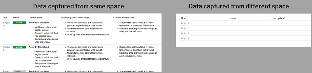

I need to display a page properties report in Space 1 that captures and displays info from Space 2 and Space 3. The page properties table includes columns for Project Name, Status, and Last Updated.
When I set the Page Properties Report up to capture info from pages within the same space, it displays as expected, but when I set it up to capture the same info from Space 2 and Space 3, only the Project Title colum is populated. Data from Status and Last Updated columns does not display.

@TS Please verify the table rows on the pages are case sensitive between all the pages. This could be the case if your page properties report is looking for Status instead of status.
Jonathan Smith
May 16, 2018
Just saw your example photo, update your page properties report macro so it displays column Status instead of status. See if that works.
TS
May 16, 2018
Thank you for the quick suggestion. It turned out to be a casing issue as suggested. I updated the parameters, and now it works as expected.
