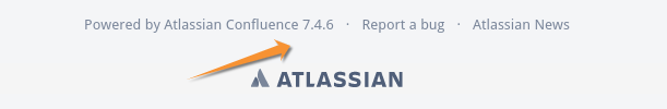

Hi @Gail Power What version of Confluence are you using? If your Confluence version is above 6.5 you can use the below document to login with recovery admin and review your user management settings if there is any connections issue. you will need an server access to update the files on back end.
You can find the Confluence version on bottom of the login page like below
