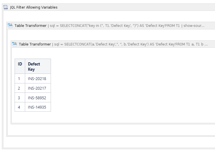

I have a table of issues that I would like to use as the input to a JQL query - essentially trying to do this:
I need a way to concatenate / sum all of the rows together into a single value:
INS-20218, INS-20217, INS-58952, INS-14935
The add the "Key in (" prefix
Then use the result as the input to the JQL.  Is this possible?

Hi @Emily Berg ,
I'm afraid, this case is not possible to implement.
The result of the Table Transformer macro will be always a table of some kind, it won't serve as an input (variable) for the JQL filter.

Thank you for the response @Katerina Kovriga _Stiltsoft_ .  Would you have suggestions other than the use of a table transformer to accomplish this use case? Or do you know if the JQL macro doesn't support this type of input?
Emily
August 26, 2021
I assume your JQL Filter comes from something similar to this and this threads, so you are able to put plain text and variables inside its body.
Or maybe the macro comes from another 3rd party app?
We've got the idea of your case but can't come up with any solution.
