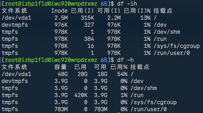

The operating system has not let it.  This could be a range of errors but the most common ones are:
  • changed permissions blocking file write
  • running out of disk space
  • running out of inodes
You will need to check those things on the server.

Ok, to follow up on what Igor asked about, as it seems to be only one file, can you
  • Check that there is nothing in the OS that might block it (virus/malware scanners for example)
  • Try uploading a larger file (ideally of the same type) and see if you get the same error
  • Manually copy the file on to the server in the same place and see what the error is there (obviously, remove it immediately if it copies ok)
By the way, Confluence should not be run as "root", it should be a dedicated non-root user who has full access and ownership of all the files in the install and data directories.

  • Have you checked if on disk permissions in "/home/atlassian/data/confluence/attachments/ver003/57/98/98307/114/65/", if these are the same as the use starting confluence, for example, if Confluence is started with "Confluence" account on disk permissions are not set to root?
  • Finally, do you have enough disk space?
    yes, it's enough.
