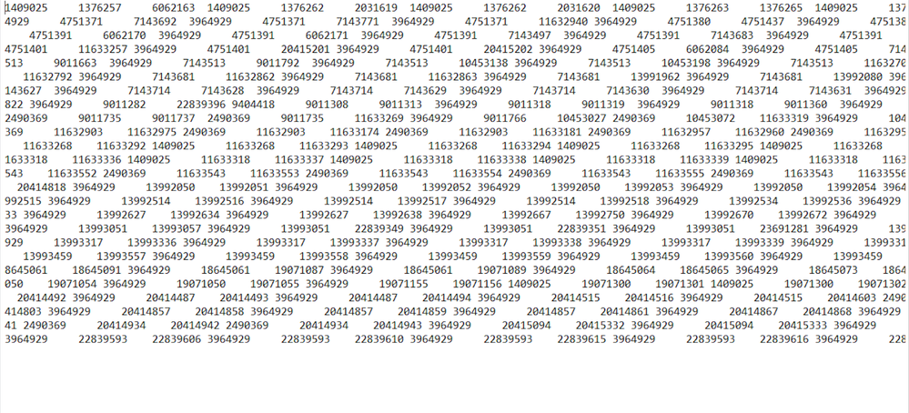

Sidenote - Attached you will see an image of my database export attachment (guide said I needed it for the python script in the link). Not sure if it helps
