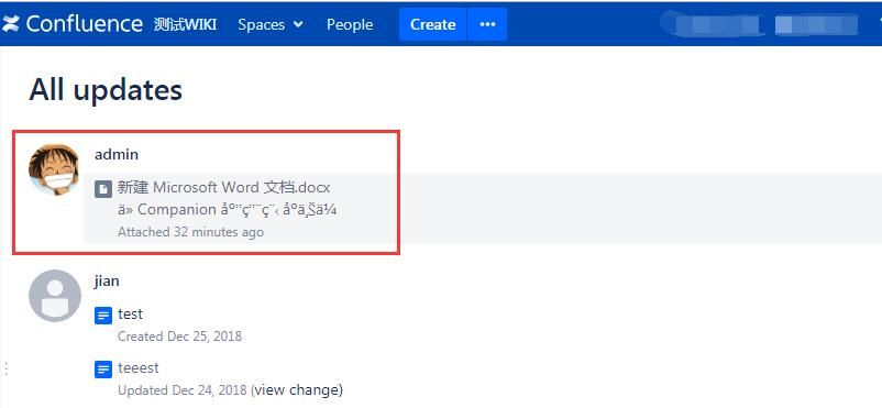

After we used office application to edit the attachment and uploaded,the update board appeared a entry with unrecognizable code .How to resolve this problem?

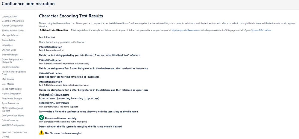

The first photo of the attachment is the character encoding test results.Please check it.

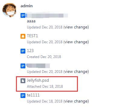

1.It only happen with office file.I do the same operation in PSD(photoshop) file,it is displayed normally in the All Update board.See the second photo of attachment.

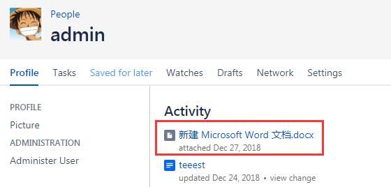

2.The issue is only found in the All Update board in currently.It is displayed normally in the account profile "Activity" page.See the third photo of attachment.
3.Yes,it affect other users.No matter which account is used to log in to the application,just open the All Update board and you will see the entry with unrecognizable code.

This is most likely being caused by some problem with the encoding settings in your database. You may want to take a look into this article:
Encoding Problem Due to Unsupported Database Configuration
Make sure to check these SQL queries:
- SHOW VARIABLES LIKE 'character_set%';
- SHOW VARIABLES LIKE 'collation%';
Also, take a look into your connection URL to see if it is using useUnicode=true and characterEncoding=utf8 flags.
For further information on the database setup for MySQL, you can access it here:
Database Setup For MySQL
