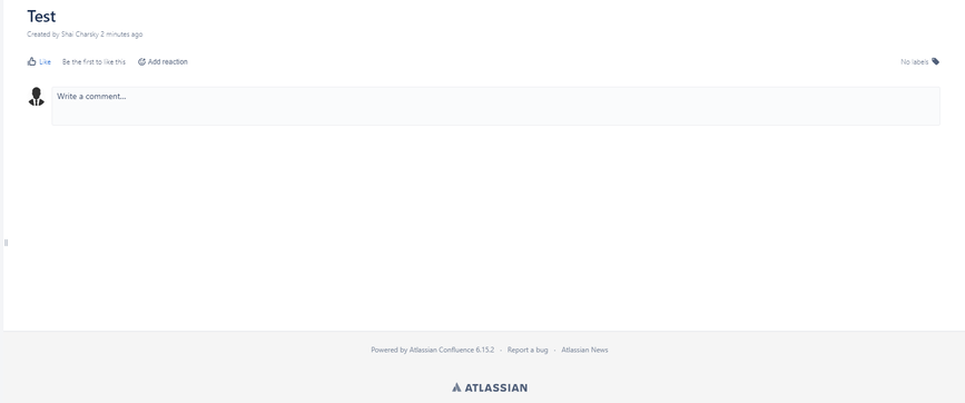

Hi Shannon,
I am using drag and drop option, i noticed after the fail message the file succeeded to upload and appears in the attachments
but the page is remain empty

Shai
May 13, 2019
The file uploaded successfully, but can not be viewed.
The following error appear:
Error formatting macro: viewfile: java.lang.NoClassDefFoundError: com.atlassian.plugins.conversion.AsposeAware
