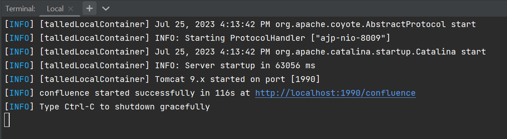

Network connectivity is not the issue, I'm afraid the previous answers you have had look like they were written by an AI that does not really understand what it is talking about, and obviously has not read your response to its first answer.
A 404 error does indeed mean "the page you have asked for is not there", but you are probably looking in the wrong place.
Your Confluence startup process tells us that Confluence is running under http://localhost:1990/confluence
That is probably true, but "localhost" means "this machine", not on the network.  So the first thing to look at is where you're trying to access it.  Is the browser you are using on the same machine as the Confluence service running on?  If it is not, then that's why you get a 404.
If it is, then the next place to look is in the logs.  You should find logs under the "target" directory of where you created the plugin code - look for atlassian-confluence.log first and catalina.out second, those are where startup errors usually get logged.

Nic Brough -Adaptavist-
July 26, 2023
Sorry, I keep forgetting most of my dev systems are altered in order to create those logs.
You need to be reading the output from "atlas-run" as it compiles and builds your app, then fires up a Confluence.
Some important points:
  • That log will end with "Tomcat started" in most cases, but that's the container not Confluence.  You're already looking at the right place under /confluence
  • It can take a long time to get started
  • Before log diving, can you check what you get from just HTTP://localhost - does it give you a white page 404, a  Tomcat 404, or can't connect to site?
  • Make sure you set your terminal to allow a lot of lines to be rolled back - the data you're going to see can be very very long
  • Read back through that log until you find "tomcat starting"
  • If Tomcat is starting, but Confluence not, you'll need to read further back!

Abhishek Eskey
July 25, 2023
Hi @Sanjen Bariki ,
Thank you for your response.
I am getting the below lines in the terminal when I try to run the local Confluence instance:
Could you please stop the server and start again from the service...? --> Could you please elaborate on this? I did not understand this step.
Did I miss anything?
I was just followed the steps mentioned in this link Write a simple Confluence blueprint plugin (atlassian.com) and got stuck at the 2nd step while running the local instance.
Thanks,
Abhishek Eskey
