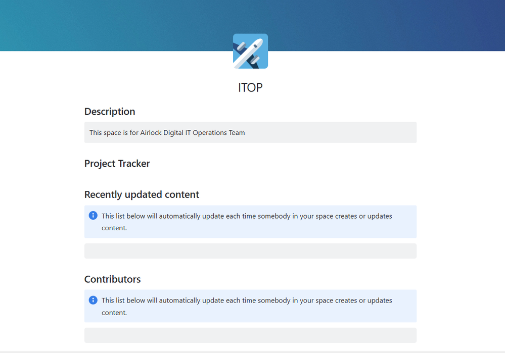

We are just trying out Confluence in our organization and what I have realized is 'Recently updated Content' comes out to be empty all the time.
Screenshot below shows empty recently updated content

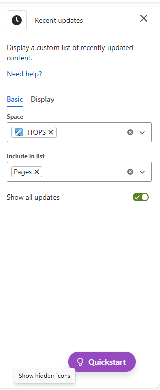

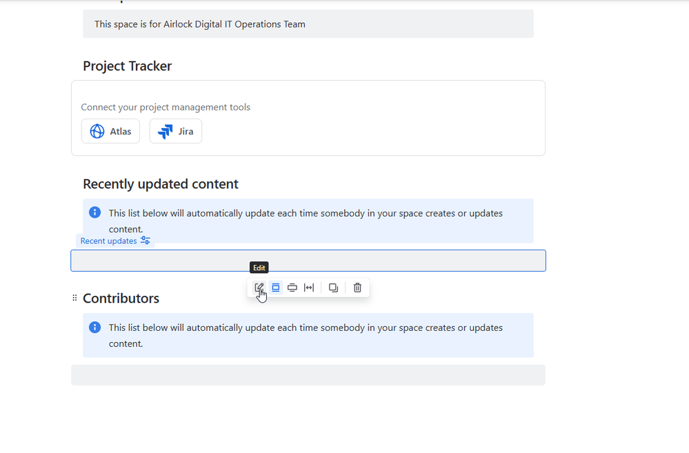

When I click on edit as per screenshot below, I have right space point and have also enabled "show all updates" but still no luck?
Wondering what is going on wrong with us?
Any leads will be very much appreciated.

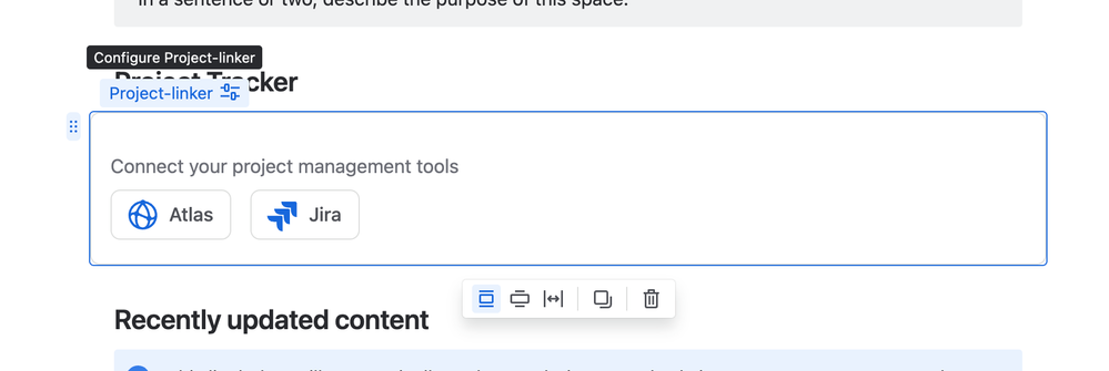

Thank you for raising this issue. In my testing, I found that if I remove the project linker, then the macros work again:
Can you try that and let me know if it works?

Wonderful! That works. However, it would also be nice to get it working with Jira tracker.
I am happy with this for now as associating Jira tracker is not a priority at the moment.
Removing the project-linker also worked for me.

Hello @Ameya Agashe
I notice that the name on the page you showed says "ITOP" while the space selected in the macro says "ITOPS". Are those the same space?
Can you confirm that some page in the space has been updated and published recently?

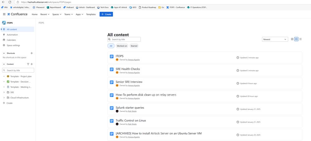

yes , 100% they are. Infact there are 10 pages updated but none of them reflected.

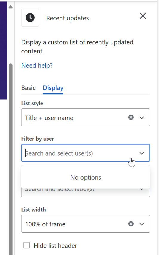

Yes I already did that but still no luck. Perhaps because we do not have "Users" and all are Space Admins? Could it be because of that? Screenshot below might you an idea of how much content is being updated but nothing is reflected on 'Recently Updated Content'
Please check screenshot below I do not see any "Users' is it because of that?
The problem is not because you are all Space Admins.
The tags on your post indicate you are using a Free subscription. Is that accurate? I am also using a Free subscription and have not been able to replicate the problem.
The Filter by user field will show selectable users if you start to type in user names. I have that field empty in my use of the macro and I'm getting accurate data in the Recently Updated macro.
