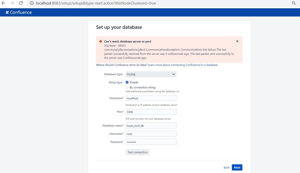

Installation was completed successfully while doing confluence setup in UI it asking database setup.
I was downloaded Mysql server in my local and I was created default root user in Mysql workbench. Then I filled hostname, port, database name, user name and password then try to test connection when below error message I am getting
Can't reach database server or port
SQLState - 08S01
com.mysql.jdbc.exceptions.jdbc4.CommunicationsException: Communications link failure The last packet successfully received from the server was 118 milliseconds ago. The last packet sent successfully to the server was 110 milliseconds ago."

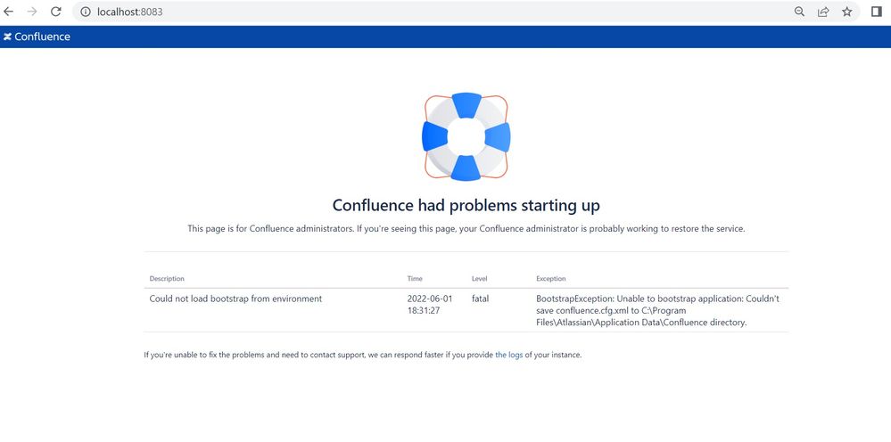

After restarting tomcat I am getting below error in UI
"BootstrapException: Unable to bootstrap application: Couldn't save confluence.cfg.xml to C:\Program Files\Atlassian\Application Data\Confluence directory."

Peruma Chinnasamy
June 1, 2022
Hi Srinatha,
No the issue is not resolved yet. Still facing same issue.bootstrap exception.jpg

Nic Brough -Adaptavist-
June 2, 2022
This is still saying the user running Confluence probably doesn't have the right permissions to create, edit and delete files in the directory it mentions
Peruma Chinnasamy
June 2, 2022
Now that error cleared
Srinatha Tondihal
June 3, 2022
@Peruma Chinnasamy , seems like DB connection issue. Do you have the DB "Local_conf_db" on your mysql database? Can you login to the DB with the root user and password which you are using above ?

Peruma Chinnasamy
June 3, 2022
Hi Srinatha,
Yes I have local database in my machine. I was created new database as "Local_conf_db"
I can able to login the database by using root user in mysql work bench and cmd.
For database I was installed mysql server and mysql work bench in my local system.
