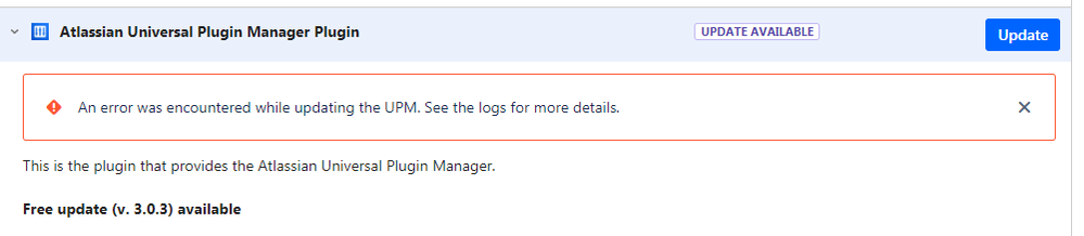

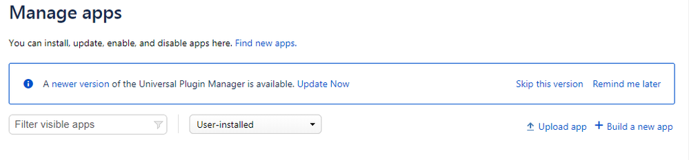

Hello all,
Since one month ago, when MANAGE APPS functionality reported there were updates for UPM, we'd tried to run the relative update but all the time we obtain a fail of this functionality; the same also for other two Apps:
  • Atlassian Troubleshooting and Support Tools
  • Cloud Migration Assistant for Confluence
our Confluence version is actually 6.15.4 and our Jira Server is 8.1.1
may we have some suggestion on how to solve this matter?
thanks for your kind attention.

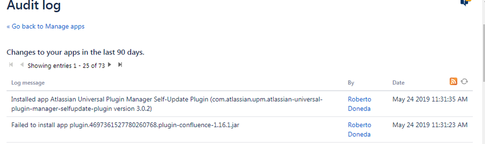

You can try the following, depending on what errors you see in your Confluence log files (not the ones in the Audit Log):
If that does not work, I am very interested to see what errors are being triggered in your Confluence Server Logs. Please feel free to trigger the error again, make a note of the timestamp, and provide any lines from your log labeled ERROR.
Thank you for your help!

We’ve just applied the article you suggested us; the result wasn’t as expected and we still have same error.
I’m trying to find log file “atlassian-confluence.log” as described into the article but I cannot find it: may you drive me to find it?
I'm asking you this because also the link you insert in "Confluence Server Logs" doesn't work..
Awaiting a reply.
Roberto

Roberto Doneda
June 3, 2019
Dear Shannon,
we'd applied your suggestion but unfortunately without success.
I noticed that there were also JVM memory sizing too low for the actual Confluence version; so we improved those parameters and now everything it's Ok.
thanks for your support.
