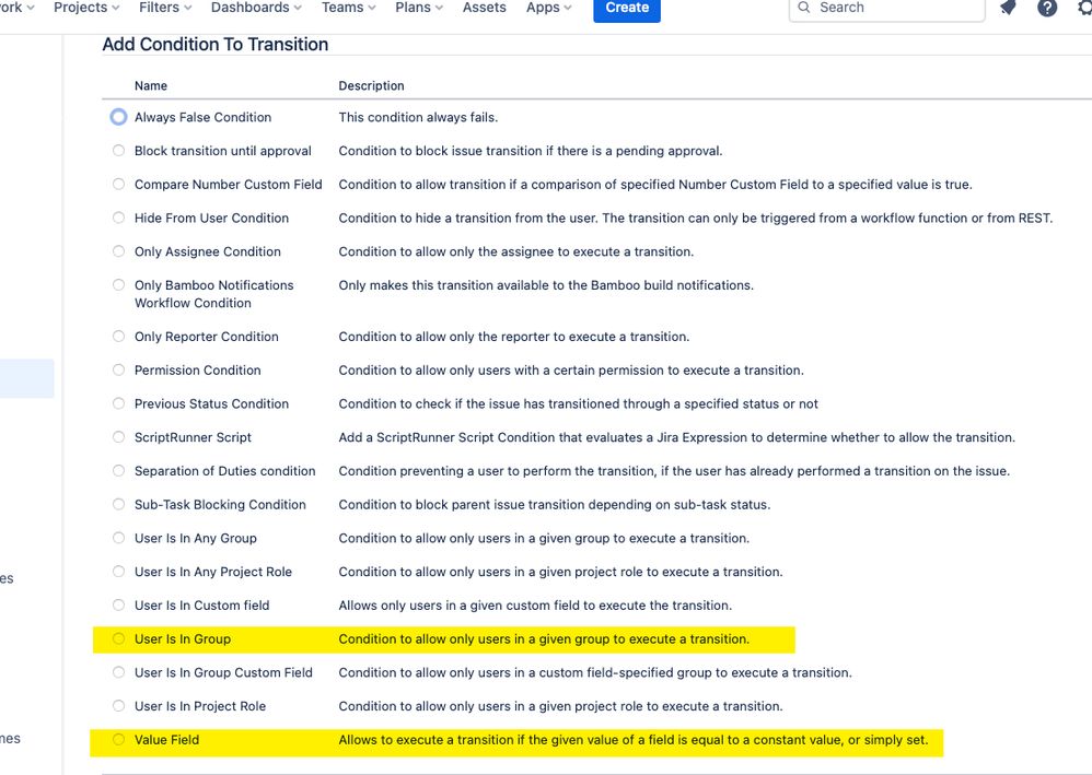

Jack Brickey
November 21, 2023
Rather than Validators you could have two Conditions: one for the only in group and the other for field value.

Jack Brickey
November 24, 2023
Conditions are "and" in nature so if you have both then both must be true. So the logic table is like this...
QA group  Found-by-QA    >   Able to transition?
      No                 No             >            No
      No                 Yes            >            No
      Yes                No             >            No
      Yes                Yes            >            Yes
