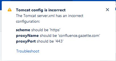

After our linux administrator installed an SSL certificate he is currently receiving the following Tomcat config is incorrect error:
He stated he followed the troubleshooting article at https://confluence.atlassian.com/confkb/can-t-check-base-url-warning-in-confluence-6-6-or-later-939718433.html and verified the settings are correct. Most likely this is due to the article being dated. Below is the server.xml file:

I think that connector definition looks right. (*assuming you replaced confluence.site.com with your sitename referenced in the screenshot. Else you have the wrong file)
I'd start with your nginx file.

Thanks for the suggestions; however, the solution did not work. We did replace confluence.site.com with our site name and tried your recommendation. Do you have another recommendation?

Start with the server.xml file. Make sure the line
scheme="https" secure="true" proxyName="confluence.site.com" proxyPort="443"/>
is changed to
scheme="https" secure="true" proxyName="confluence.gazette.com" proxyPort="443"/>

Are you still able to help me with this issue? If not, do you know how I can disable the URL base checking as the article suggests? I tried looking for the addon option when clicking the cog in Confluence and it is not there.

So you updated the line in your server.xml (in the correct uncommented section), and restarted confluence and you are still getting the exact same error?  Can you repost your server.xml file with the corrections, since the one above is not correct.

Hello! I have a problem, too. a string in the server.xml
scheme= "https" secure= "true" proxyName="atl.mysite.su" proxy Port= "443"/>
Mistake
The Tomcat server.xml has an incorrect configuration:
the scheme should be 'https'
proxy Name should be 'atl.mysite.su'
proxyPort should be '443'
There is no nginx httpd configuration file
Confluence 6.9.1
