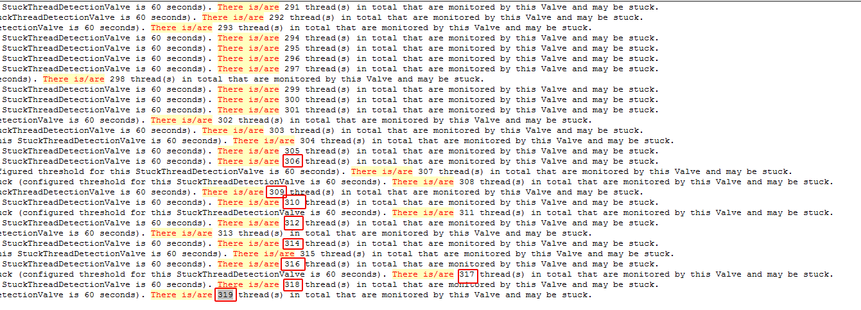

here is the thread logs:

Thread "http-nio-8092-exec-204" (id=438) has been active for 67,139 milliseconds (since 1/9/18 6:34 PM) to serve the same request and may be stuck (configured threshold for this StuckThreadDetectionValve is 60 seconds). There is/are 217 thread(s) in total that are monitored by this Valve and may be stuck.
