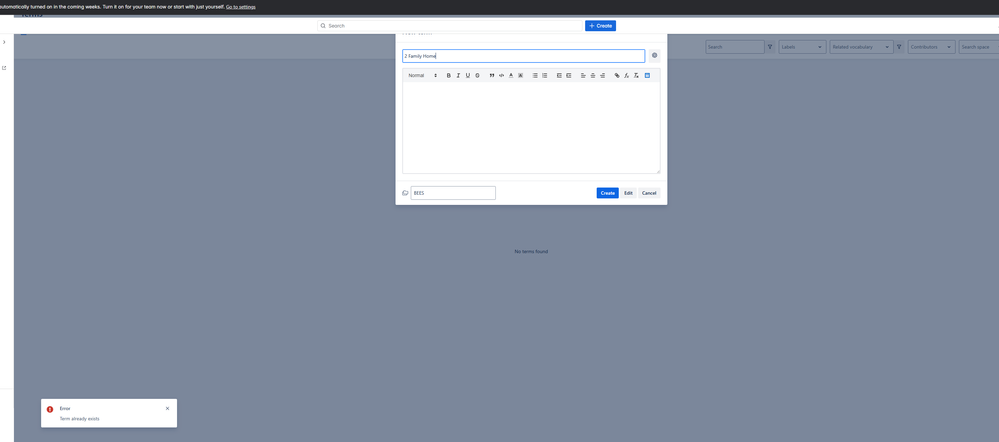

I used Confluence's migration assistant to transfer the data from the local space to the Cloud version, and then installed the Smart Terms app. However, no data is shown in the app. When I try to manually create the same terms as in the local version, it prompts that the terms already exist.
I've tried rebuilding the index from the system setting, but the data still doesn't display. What should I do to make the migrated term data show up in Confluence Cloud? If it can't be displayed, how can I delete that migrated data so that I can migrate by exporting the local data and importing it into the Cloud version?
